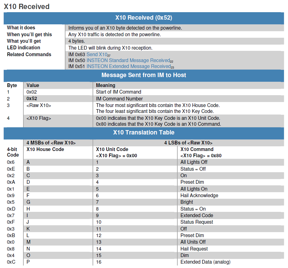

I don’t think these devices transmit anything on the powerline. That is their big downfall, its “send a pray it was received”, there is no ACK. I have some other stuff that will transmit on the powerline and I’ll see if I can give that a try.
Yes, I’ll probasbly try both of these things tomorrow.
The Insteon developer manual seems to imply that (unsolicited) X10 messages can be received.
It could be commands sent by another X10 transmitter on the powerline. Maybe the test should be that you send a command via the CM11A binding while having the Insteon binding connected to your IM. You should see an item state change event in your logs for the relevant Insteon X10 item.

Thanks again. I can see an issue with how a full x10 address is parsed. This one is only related to the legacy implementation since the new one has separated house/unit configuration. I will fix it and provide an updated build.
@Runnerk I uploaded an updated build with the fix in the link above. Can you give it a try? Thanks again for doing the testing.
Thanks @jeshab.
All devices are online now. Also tested the sensor and its working as expected.
As far as I tested, everything is working as it was before the update to 4.3.1.
