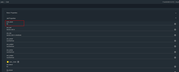

  2. Add the script as a startup script in the FreeNas Gui.
  3. Add the created alternative devfs ruleset to your openHAB jail (ruleset 99 created in step 7).
    screenshot 2 next reply

screenshot2
