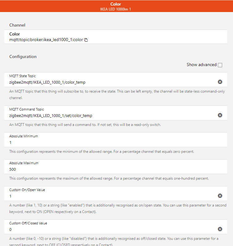

Below my example for color temp of one of my IKEA bulbs:
Screenshots:
I do not have an R, G, B IKEA light to test others as they do not exist in our market.
But I would assume, as @Vradatta showed, you can command them via the RGB channel.
