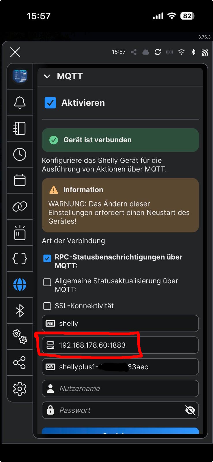

I just answered a similar question in a german board.
I assume that you have an MQTT broker running.

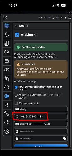

You enter the broker adress under Settings / MQTT in the Shelly app for the device that acts as the interface to the BLU device (red box)
(screenshots in German only, sorry for that)

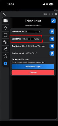

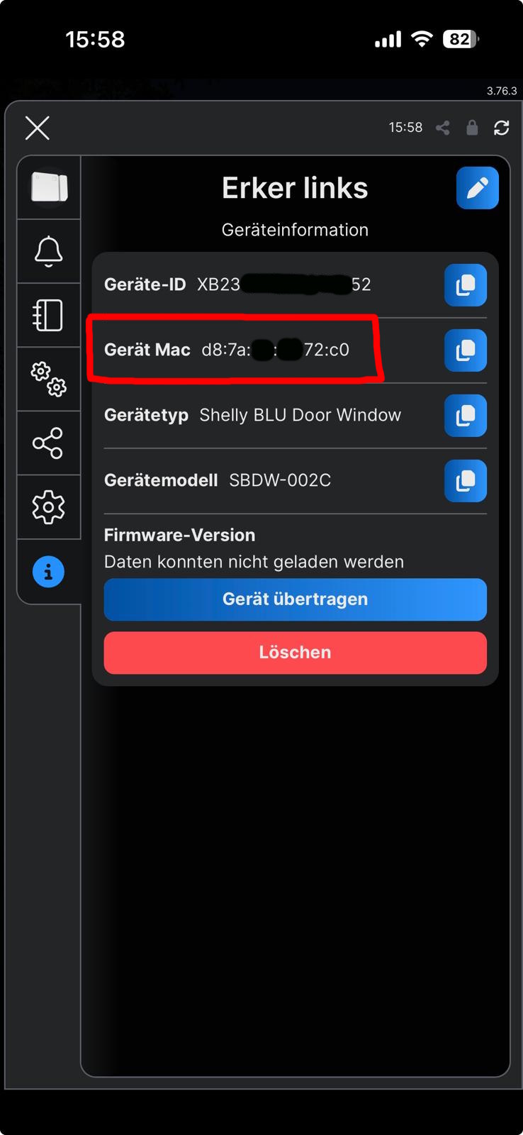

Then, also in the Shelly app, you look up the MAC address of the BLU device:

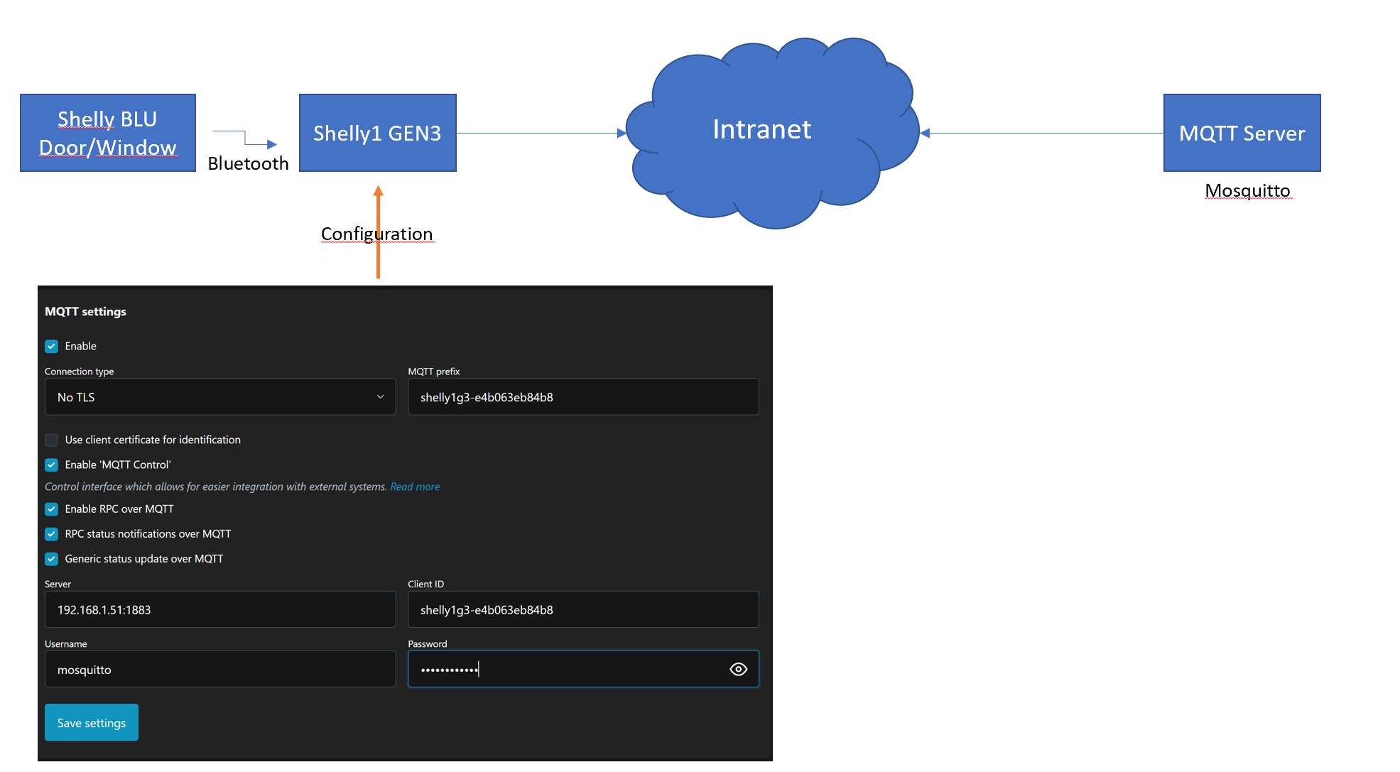

In attachment I send you a file with the architecture of the components involved, with the configuration of the Shelly1 GEN3 regarding the MQTT. By the way, the Shelly is communicating with MQTT publishing internal events.

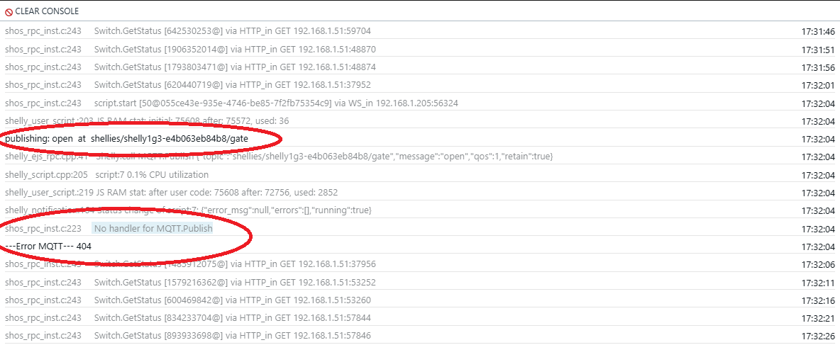

The publish issue I have is regarding the publishing of a topic using the script which I show below:
// Publica manualmente no MQTT
let msg = “open”; // payload
let topic = “shellies/shelly1g3-e4b063eb84b8/gate”; // generic topic to show the gate status
print(“Testing publishing:”, msg, “em”, topic);
Shelly.call(“MQTT.Publish”, {
topic: topic,
message: msg,
qos: 1,
retain: true
}, function(res, err) {
if (err) print(“—Error MQTT—”, JSON.stringify(err));
else print(“—MQTT OK—”);

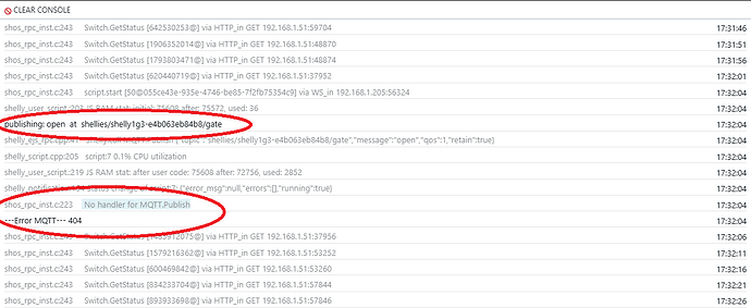

the result is: —Error MQTT— 404 (meaning “No handler for MQTT.Publish”)
I send you in attachment the deviceinfo from shelly1 GEN3, the logs from the device and the logs from the MQTT extracted from the mosquitto_sub which evidences that the shelly is publishing in MQTT.
Thank you very much,
João
MobaXterm_192.168.1.51joao_20260407_163246.txt (32.1 KB)
debug-log-shelly1g3-e4b063eb84b8 (14).txt (25.3 KB)
data-shelly1g3-e4b063eb84b8 (1).txt (9.8 KB)
Try MQTT.publish
