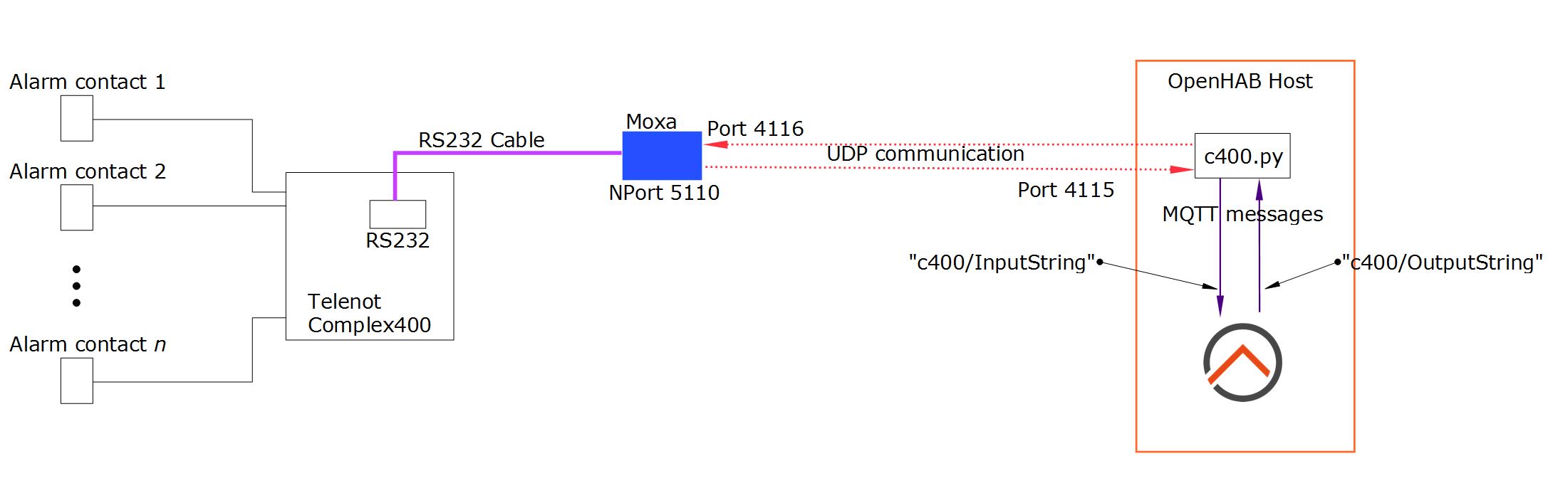

Assuming that you have adressed those issues successfully, let me explain the setup, shown in the picture below.
You will need:
  • Telenot complex 400 (the GMS protocol will most likely be available on other Telenot units as well, your mileage may vary)
  • RS232 cable
  • Moxa Nport 5110 RS232 ↔ IP converter (newer units will probably work too)
  • Host with MQTT broker installed (I use Mosquitto). Python and the PAHO MQTT library for Python installed
  • OpenHAB with MQTT binding enabled and configured
We have the Telenot Complex 400 unit, that monitors the contacts that we are interested in. There’s an RS232 port on the system mainboard that can be enabled for the GMS protocol by your system integrator. Any ā€œnormalā€ system will have this turned off, so you will have to approach your system integrator to activate it for you. It might be possible to hook this serial cable directly into your openhab host, but that’s not what we’ll do (mine simply was too far away…, and I guess you might have a hard time connecting a RS232 cable to a RasPi anyhow..).
Instead, we’ll use a Moxa NPort 5110 serial to UDP converter that takes the signals from it’s serial port, and packs them into nicelyformatted UDP datagrams and sends them to our openHAB host (or any host, I just chose to have my UDP packets received by the openHAB host). Also, we will configure the NPort 5110 to send UDP datagrams that we send to it onward via it’s RS232 port to the Telenot unit (the GMS protocol is bidirectional, you won’t get data from your complex 400, if you don’t send ACKs to its packets). This guy here is the main security risk, since you effectively cannot control, who sends data to the Nport that gets passed on to the complex 400. You can configure some host limitations to limit who is allowed to send data, but since you’re not expecting any return data as a black hatter, IP spoofing will probably work. So once again - make doubly sure that your home IP environment is clean and protected. Consider using a physically separate ethernet segment between your openHAB host and the NPort if possible.
We will later touch on a small python script that attaches to a UDP socket to receive the data from the NPort 5110. It will take the data off the wire, convert the binary data into a hex stream, and publish that to the MQTT Topic ā€œC400/InputStringā€.
The script will also subscribe to the MQTT Topic ā€œC400/OutputStringā€ and send the hex stream it gets on that topic to the Nport where it will get passed on to the Complex 400 unit.
On OpenHAB, we will also use the MQTT binding to subscribe to the C400/InputString topic. This is our input data that we will need to decode. We’ll use the C400/OutputString topic to publish our ACK messages and propagate them back to the C400.
We’ll go into the details of how to set up the different components next (bear with me, it takes some time to write it all up, so watch for the posts to update/add over the coming days)
