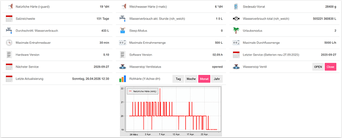

The purpose of this topic is to provide a possibility to intergrate the Judo “i-soft plus” water-softener into openHAB. The screnshot shows the relevant parameters in BasicUI used for PC and iPhone.
Am a Windows11 user and run OH 5.2.0-SNAPSHOT #5309.
The judo.items file looks like following:
Number residual_hardness_setpoint
Switch Curl_Judo_WasserstoppVentil "Wasserstopp-Ventil"
String water_current "Wasserverbrauch aktuell"
String water_total "Wasser gesamt"
String water_average "Durchschnittlicher Wasserverbrauch [%1$s l]"
String actual_quantity "aktueller Verbrauch"
String salt_quantity "Salzmenge [%1$s g]"
String salt_range "Salzreichweite [%1$s Tage]"
String residual_hardness "eingestellte Härte [%1$s °d]"
String natural_hardness "Natürliche Härte [%1$s °d]"
String valve "Wasserstopventilstatus"
String standby "Standby"
String vacation "Ferienmodus"
String abstraction_time "Abstraktionszeit"
String quantity "Abnahmemenge"
String flow_rate "Durchfluss Grenzwert"
Number rawwater "verbrauchtes Rohwasser [%1$s l]"
Number decarbonatedwater "verbrauchtes entkalktes Wasser [%1$s l]"
String software_version "Software Version [%1s]"
String hardware_version "Hardware Version [%1s]"
String notice_event "Event Message [%1s]"
Number service_date "Service Datum [%1s]"
String service_date_time "Service Datum [%1s]"
Number next_service_date "Nächster Service [%1s]"
String next_service_date_time "Nächster Service [%1s]"
Number actual_date "Letzte Daten [%1s]"
String actual_date_time "Letzte Daten [%1s]"
DateTime water_total_update "[%1$tm/%1$td %1$tH:%1$tM]"
In order to read out the Judo “i-soft plus” data, i run a command_judo.bat using a cron rule every 30 minutes. CURL and JQ (jQuery) commands are used in order to retrieve the required data. CURL is used to send a request to the water-softener and JQ is used to extract the desired parameter from the response string. Response string and final value are both stored within .txt files for further processsing

It is not a very comfortable way to read out the machine parameters but its running here very reliably since a couple of years and is independend from openHAB versions and upgrades.
I hope, that it might help other users.
