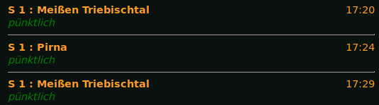

I’ve integrated the data from local public transport (Germany, Dresden region, VVO) to my HABPanel. They provide a nice API that gives tram, bus and train data with real-time delay information. My solution is a small HTML/Javascript file that is shown in an iFrame widget.
Here is a screenshot (orangetree style) and the code.
