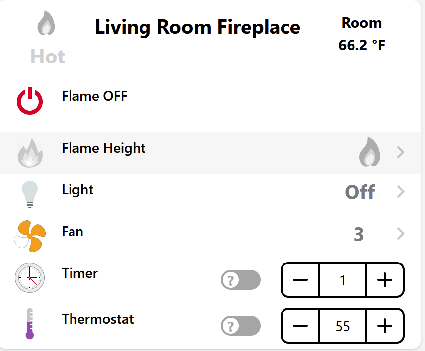

I’ve been trying out the Fireplace binding again. I also created a custom widget for it. The widget acts a little weird when setting some the light or flame levels because of the timing between when the command gets sent and when the poll is taken to check the settings. Other than that it seems ok. With the fireplace connected to OH, now I can write rules for other items, for instance, I can turn the ceiling fan on a few minutes after the fireplace fan comes on, and turn it off a few minutes after the fireplace goes off.
I’m including the widget below. Once again, thanks to Justin G and rikoshak for all of their widget tutorials. I did create some custom icons for the flame and fan feedback that I can share if I can find a way to do it.

I’m not sure I understand the timer. If I set the Timer number to 1, it sets the timer for 1 hour when I turn it on. If I set it to 0.0167 ie 1/60 it still sets the timer for one hour when I turn it on. Since the timer is actually a function in the remote, I’m tempted to use a timer in an openHAB rule instead.
Timer units are minutes. Integers only. If I set mine to 15, the remote says 15 minutes remaining.
