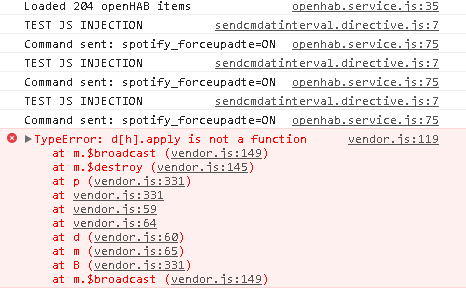

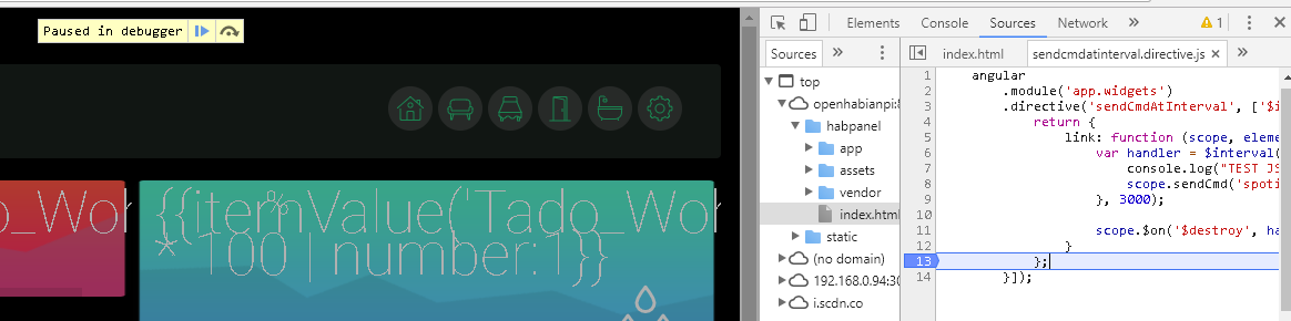

if the debugger shows up, it looks like this:
as you can see, I added a console.log statement, which is never seen in the console..
Thanks,
Ben

Ah yes, looks like you can’t lazy-load a directive and use it on the same element.
I know that was what I suggested in my earlier post and I was wrong - sorry.
The directive has to be invoked on another element down the tree. in your particular case, since it doesn’t really matter where you put it, instead of adding another <div> you can simply move it to the sectionIconContainer, title or controls one.
<div class="section" oc-lazy-load="'/static/sendcmdatinterval.directive.js'">
<div class="sectionIconContainer"><div class="sectionIcon"><svg viewBox="0 0 48 48"><use xlink:href="/static/matrix-theme/squidink.svg#line-visuals"></use></svg></div></div>
<div class="title">Musik</div>
<div class="controls" send-cmd-at-interval>

Thanks, that really did it! I would never have thought that could be the reason…
Just one thing is still mysterious to me:
The type error appears when I change the view - and the $interval is still alive. Seems like the $interval isn’t destroyed because of the error?
I tried removing the array in the JS described as here: javascript - TypeError: d[h].apply is not a function - Stack Overflow but that didn’t help.
Cheers
ysc
(Yannick Schaus)
November 21, 2017, 12:44pm
7
My example definitely shouldn’t be taken as face value
According to AngularJS you should call $interval.cancel(handler) to cancel the repeated task; so something like
scope.$on('$destroy', function () {
$interval.cancel(handler);
might work better.
