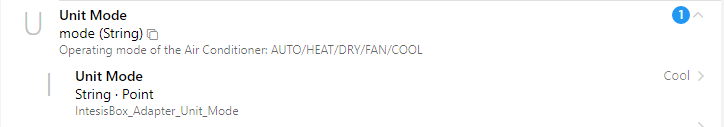

My challenge relates to to device on/off. The default modes (separate item to power) only lists modes such as cool, heat etc. So whilst I can adjust temperature and mode, I cant actually turn off/on the thing.
Thanks @hmerk for the quick response. Apologies, I still learning the nuiances of OpenHab.
Understand how to create the rule once I have the proxy item/mode however how to I create or add that. At the moment, I only have the default values and not sure how to add/amend.
If your screenshot should show the proxy item, you did not understand what a proxy item is.
Sorry if this sounds a bit harsh, it is not meant to be.
A proxy item is an item whithout any channel linked to. So basically here it is a String Item which can have the states OFF/AUTO/DRY/FAN/COOL
Let’s call the Item
IntesisBox_Adapter_Unit_ModeProxy
