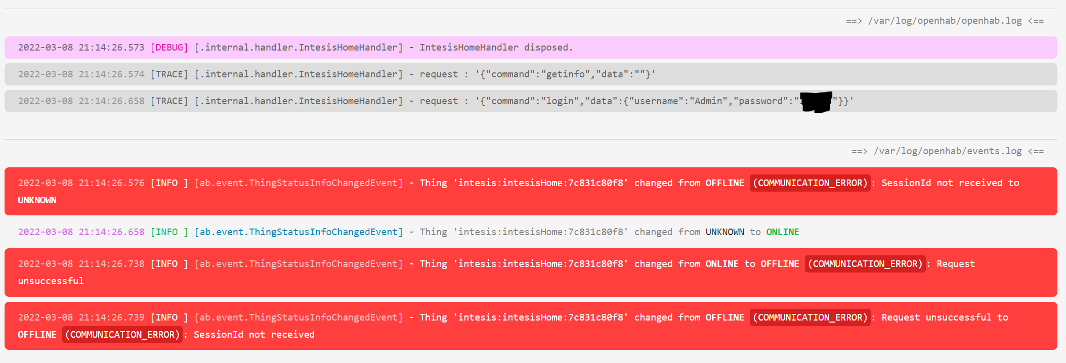

I have tried a couple of options via the GUI with the resulting logs IntesisHome
2022-03-09 11:29:53.558 [TRACE] [.internal.handler.IntesisHomeHandler] - request : '{"command":"getinfo","data":""}'
2022-03-09 11:29:53.639 [TRACE] [.internal.handler.IntesisHomeHandler] - request : '{"command":"login","data":{"username":"Admin","password":"xxxxxx"}}'
2022-03-09 11:29:53.545 [INFO ] [ab.event.ThingStatusInfoChangedEvent] - Thing 'intesis:intesisHome:0db4cfba86' changed from UNINITIALIZED to INITIALIZING
2022-03-09 11:29:53.559 [INFO ] [ab.event.ThingStatusInfoChangedEvent] - Thing 'intesis:intesisHome:0db4cfba86' changed from INITIALIZING to UNKNOWN
2022-03-09 11:29:53.639 [INFO ] [ab.event.ThingStatusInfoChangedEvent] - Thing 'intesis:intesisHome:0db4cfba86' changed from UNKNOWN to ONLINE
2022-03-09 11:29:53.707 [INFO ] [ab.event.ThingStatusInfoChangedEvent] - Thing 'intesis:intesisHome:0db4cfba86' changed from ONLINE to OFFLINE (COMMUNICATION_ERROR): Request unsuccessful
2022-03-09 11:29:53.711 [INFO ] [ab.event.ThingStatusInfoChangedEvent] - Thing 'intesis:intesisHome:0db4cfba86' changed from OFFLINE (COMMUNICATION_ERROR): Request unsuccessful to OFFLINE (COMMUNICATION_ERROR): SessionId not received

I am more convinced this is an username / password error. I found a script from @pelnet which I have managed to get running (well outside my comfort zone). Im using the same password I use to access Intesis AC Cloud, both web interface and App.
As for sniffing the traffic, that’s going to be a bit tricky as it’s all SSL. You might be able to do a man-in-the-middle with something like Squid using peek/splice, but it’s not going to be easy.
That makes sense, however I don’t recall setting local credentials when I installed the device. Tomorrow I’ll reset the device and start from scratch and see if there is anywhere to set local credentials. I had “assumed” the the cloud credentials were passed to the device.
I have it working - thanks
I entered the password for the IntesisHome (guess). I do not recall seeing an option to enter the PW in the setup phase, it was either not there or I skipped over it in my haste to get the thing working. I may in the future do a factory reset to check where the PW is entered. I had assumed the PW for the cloud was passed to the box, alas that is not the case.
