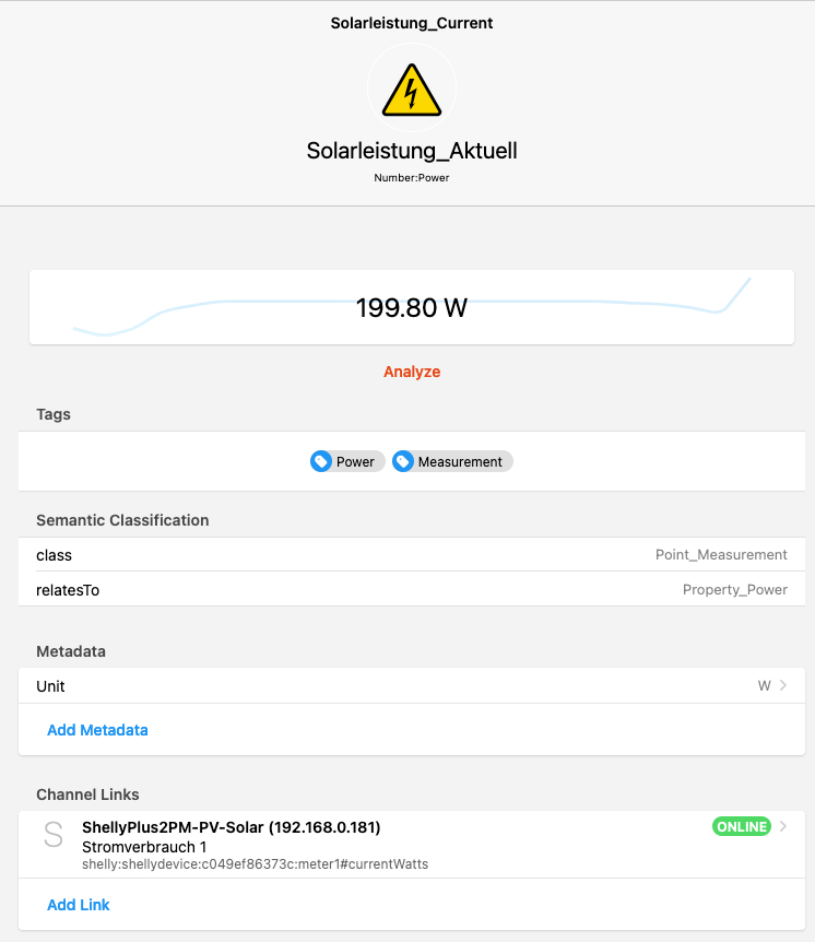

In this case I’ve defined thing and item via GUI, but I’m open for files, too.
How may I apply an “inline script”? Does it require an item file?

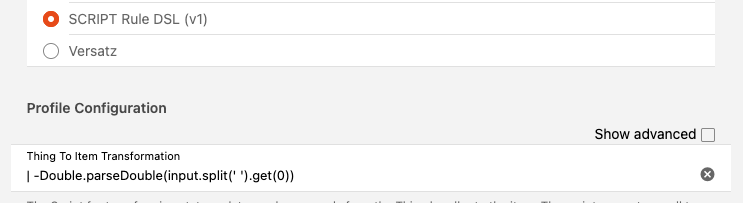

The attempt from the following screenshot results in
" [ERROR] [n.module.script.profile.ScriptProfile] - Failed to process script ‘DSL(| Double.parseDouble(input).doubleValue * -1)’: Could not get script for UID ‘DSL(| Double.parseDouble(input).doubleValue * -1)’.

Right, when setting up via UI, you already passed the DSL information, so in the field
Thing to Item transformation set only
| -Double.parseDouble(input).doubleValue
or

This is the shortest variant working for me:
| -Double.parseDouble(input.split(' ').get(0))
I don’t need to add the unit, since the item carries the unit within its metadata.
