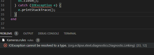

IOException cannot be resolved to a type
I use a snippet from other posts. The function works well, but my Visual Studio Code editor shows me some problems:
The files are saved and can be used to send it via Pushover.
The full rule file:

What is wrong with the IOException Code?

Too bad nobody could help me. In the end it was very easy, because only one class had to be loaded, namely java.io.IOException.
The original author had imported everything from io that I had commented out.
After I corrected the block at the beginning, there was no error message anymore.
// Importe, um Kamerabilder abzuspeichern
import javax.xml.bind.DatatypeConverter
import java.io.File
import java.io.FileOutputStream
import java.io.OutputStream
import java.io.IOException // this line was missing
