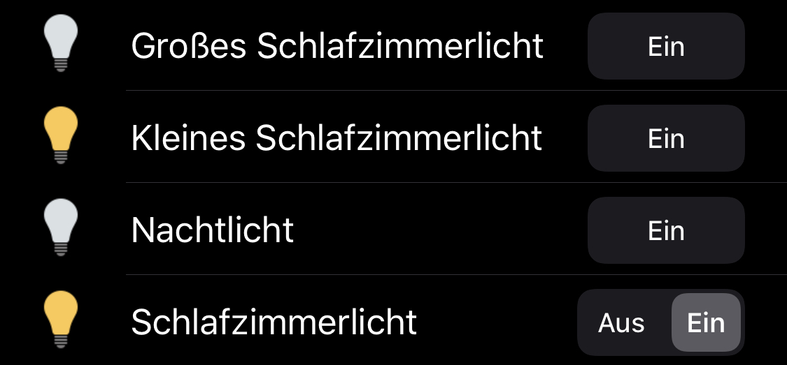

Great update and I love the darkmode but I found one bug.
When using a mapping for a switch that only shows one of the two options (only on or off) it doesnāt highlight anymore when the Switch item is set to the corresponding setting. You can see it here on the second one from top.
The icon still behaves correctly but the button itself only turns visually on for a split second. As you can see in the last row of the picture it works for a mapped button that represent both possible positions.
Thanks for the great work again.
Best regards Johannes
@JGKK thatās how itās supposed to work and is consistent with other clients. If you want to visualize the item state, either use a proper Switch
item or use a visibility attribute in your sitemap to reflect the current state through the label.
Than I guess it was a bug in the Ios app versions before. Because thatās how it behaved ever since I used it
I really liked that bug for my use case
Iād recommend to use a switch without mappings to represent items with a binary state (on/off).
Not here because itās scenes that actually donāt have a turn off option or need one, they only get turned off by other scenes or the room master at the bottom.
Sounds like youāll need multiple sitemap items with visibility attributes, but Iāll need more details about your use case. Please start a new thread, tag me and maybe we can work out a solution.
Thank you for reporting. I created an issue on github
