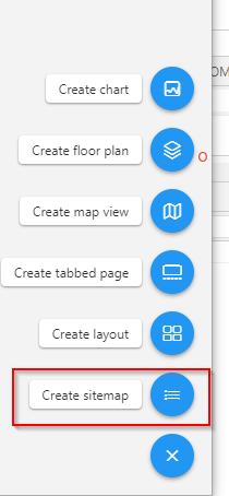

You can create a sitemap in OH3 from Settings-> Pages ->+(lower right).

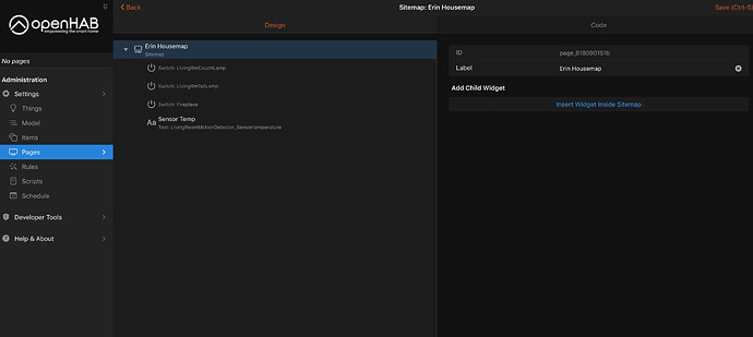

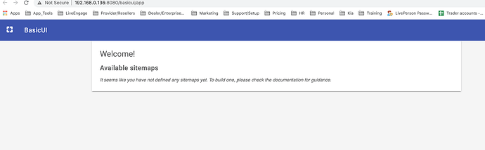

So this let’s me create a sitemap just fine, but then when you click on the Basic UI it always just says there is no sitemaps created. There must be some config setting that’s wrong?

It must be not pointing to the right index or something. I just uninstalled BasicUI, reinstalled, and restarted OH, and it’s still saying there are no sitemaps despite me having 3 built…
