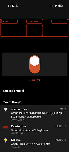

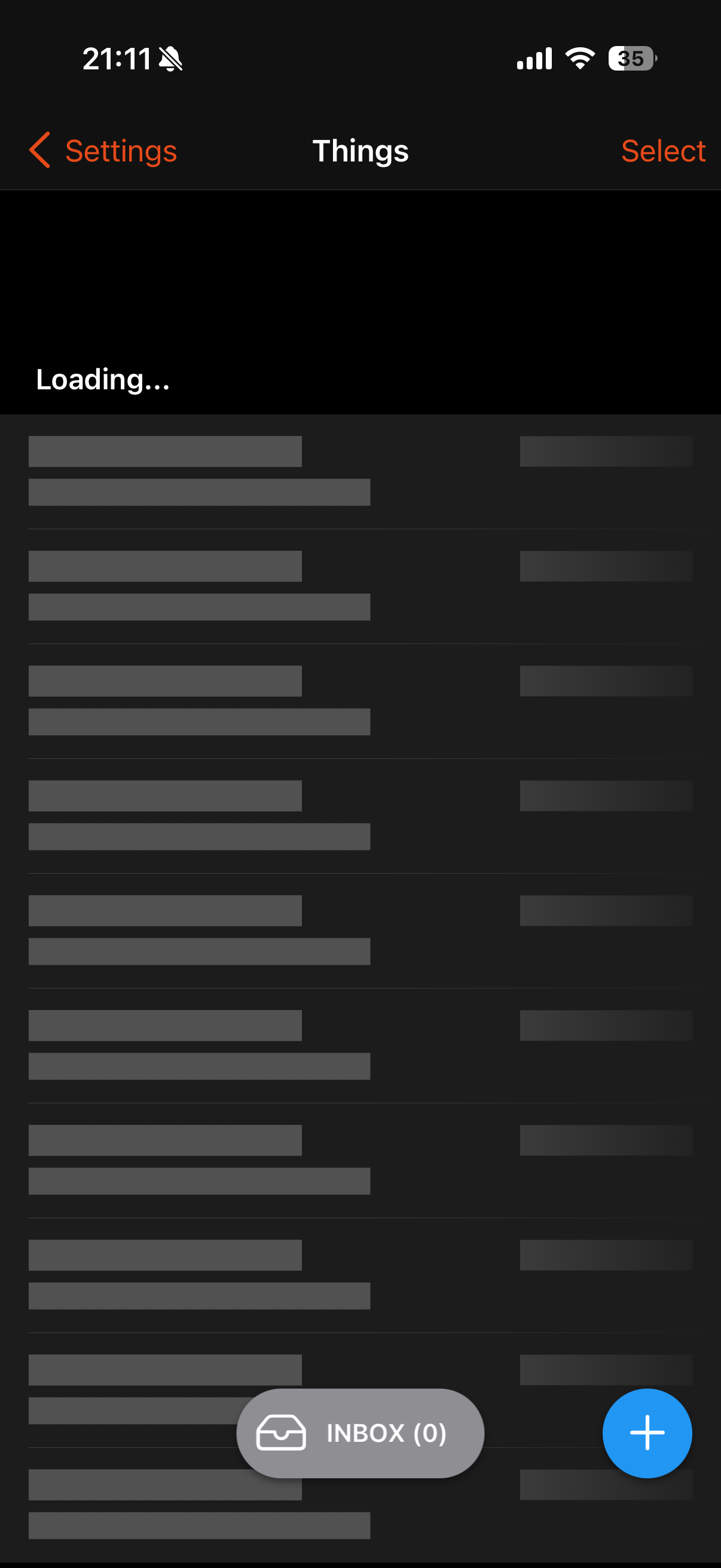

  1. Settings→Things: page is not displaying things list. The animated background does not stop. However, list of items (1700) is visible after a few seconds

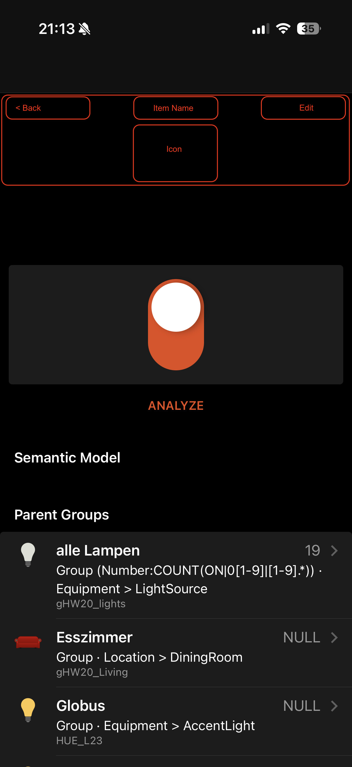

  2. Settings→Items: Items View - top section with Back, Edit buttons, Item name and Icon is not visible
  3. Main page→Locations, Devices, Property badges - Background images are not loaded, but they are perfectly fine on a Web browser (e.g. Safari, Chrome)
Does anyone experience similar issues? Any idea how I could further investigate? I do not have any clue, if it is related to the iOS app version, openHAB version or a combination of both.
