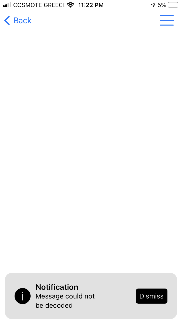

when inside the app i get “message could not be decoded” although I can read in in the notifications later and it also appears normally on the lock screen

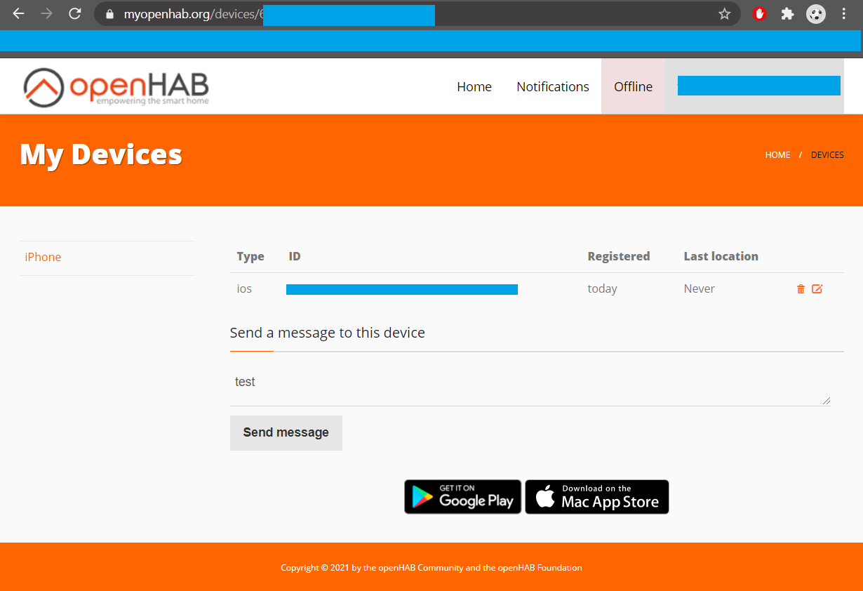

It’s probably not related to the local instance of openhab, since the behavior is the same when sending a message directly from myopenhab.org.
It’s probably not related to phone settings since it started across multiple devices at the same time.
Reinstating the app does not help.
I even went as far as removing the app. Creating a new myopenhab account with no instance of openhab connected to it. installed the app, connected to this account and sent a message directly to the device. same. Once, though, it played half a sound for SOME reason…
