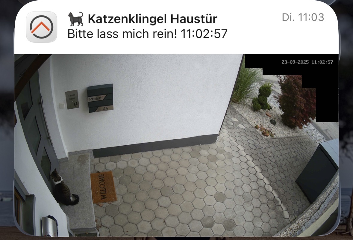

Previously I was able to send:
• a custom title
• a media attachment (image)

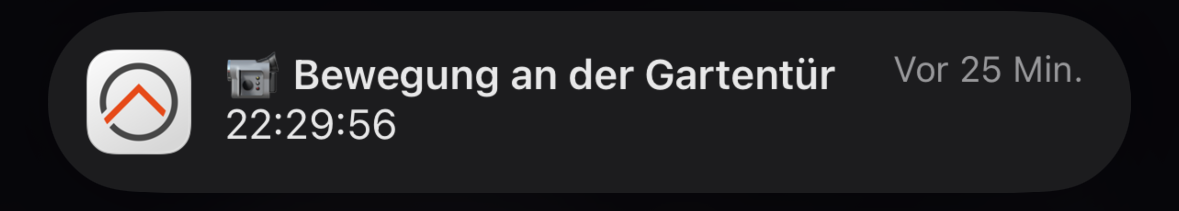

Now:
• the title is always just “openHAB”
• the media attachment is missing completely

Previously:

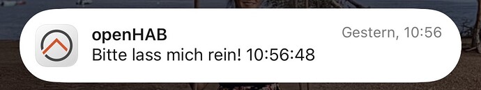

Now:

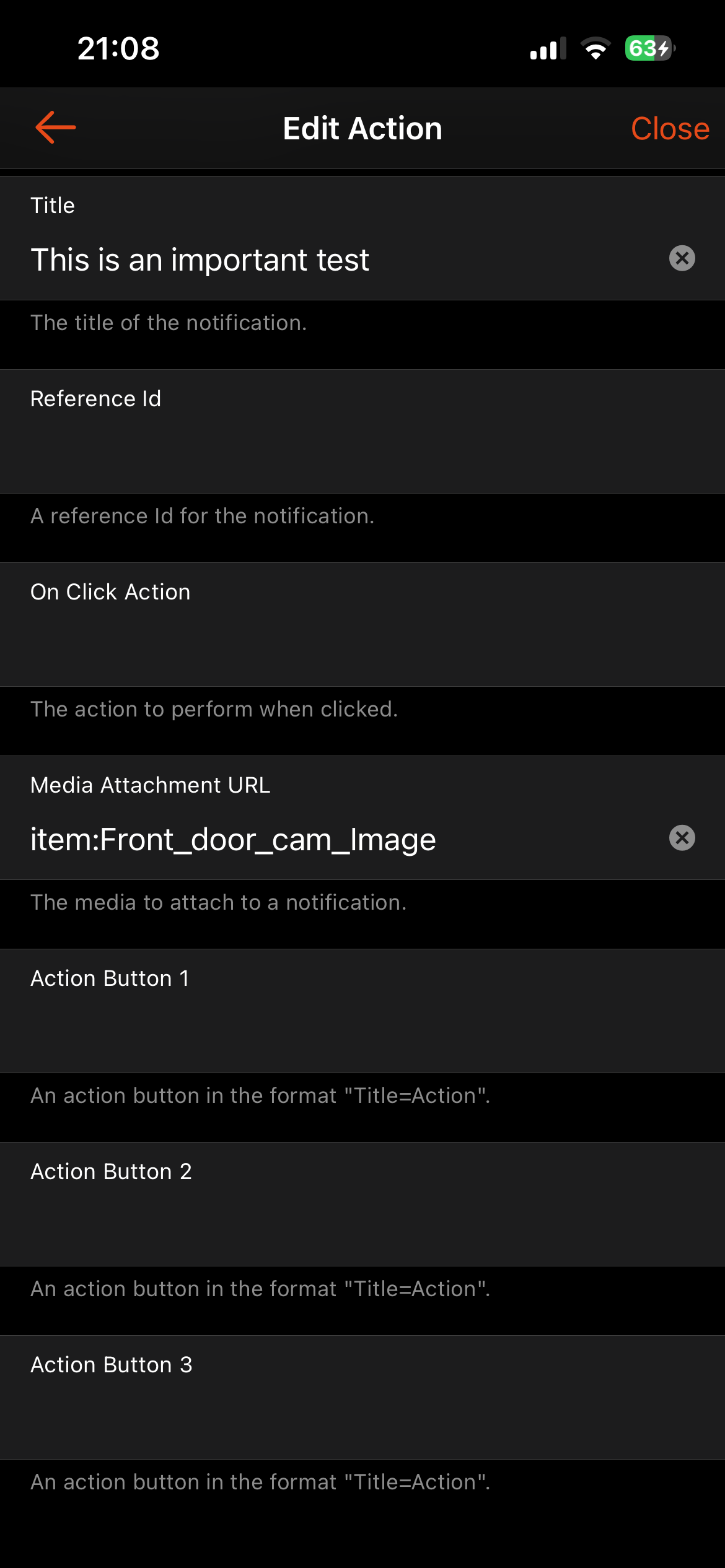

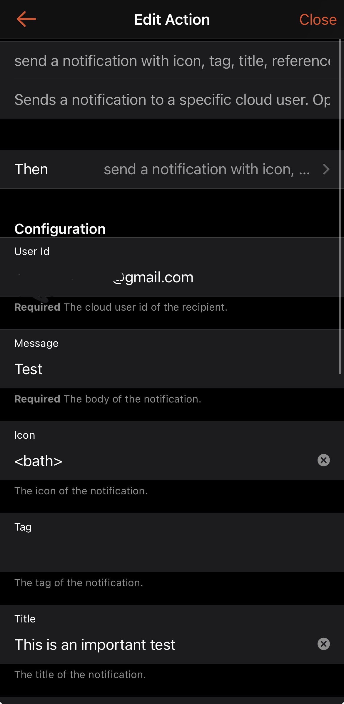

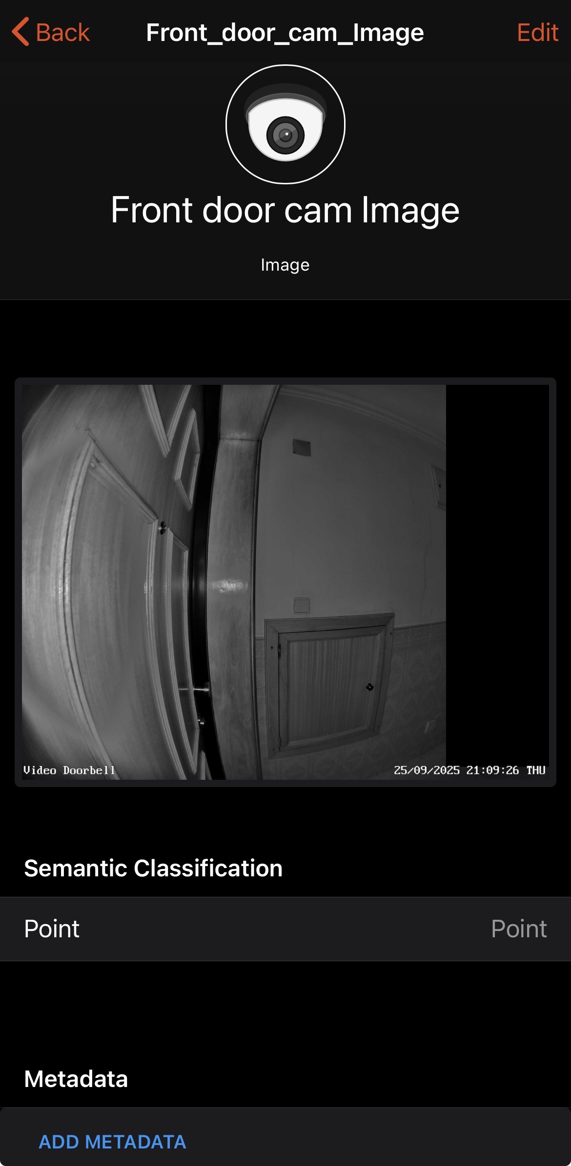

@Anpro thank you! I’m starting slow, just a basic notification with a title and an image snapshot and I’m already seeing the same as you:
A notification sent with a message, title and an image.
I tried with both a static url to a locally hosted image, and the item itself with item:{item name}
No field appears to work except for the message.
I followed this content:
and this was the result:
Configuration
Imagine item:
Result:
And in myOpenHAB I see similarly:
So my feeling is that either I’m doing something terribly wrong or, there’s a bug in the machine :smiley:

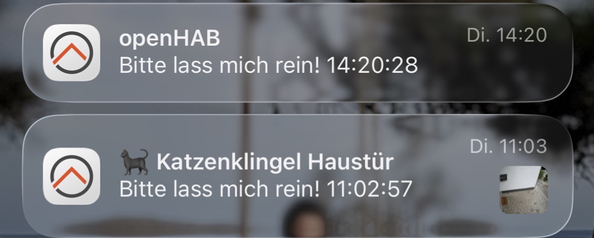

As far as I’m concerned, I’m almost certain this must be a current bug.
I can even narrow down the time window when it started happening: this Tuesday between 11:02 and 14:20 CEST (Central European Summer Time, UTC+2).
Important detail: I send all my notifications through a central rule, which then decides whether to use Telegram or iOS Push depending on the recipient.
•	Telegram still works perfectly.
•	For iOS
Push, only the messages with a media attachment are affected — all others still work as before!

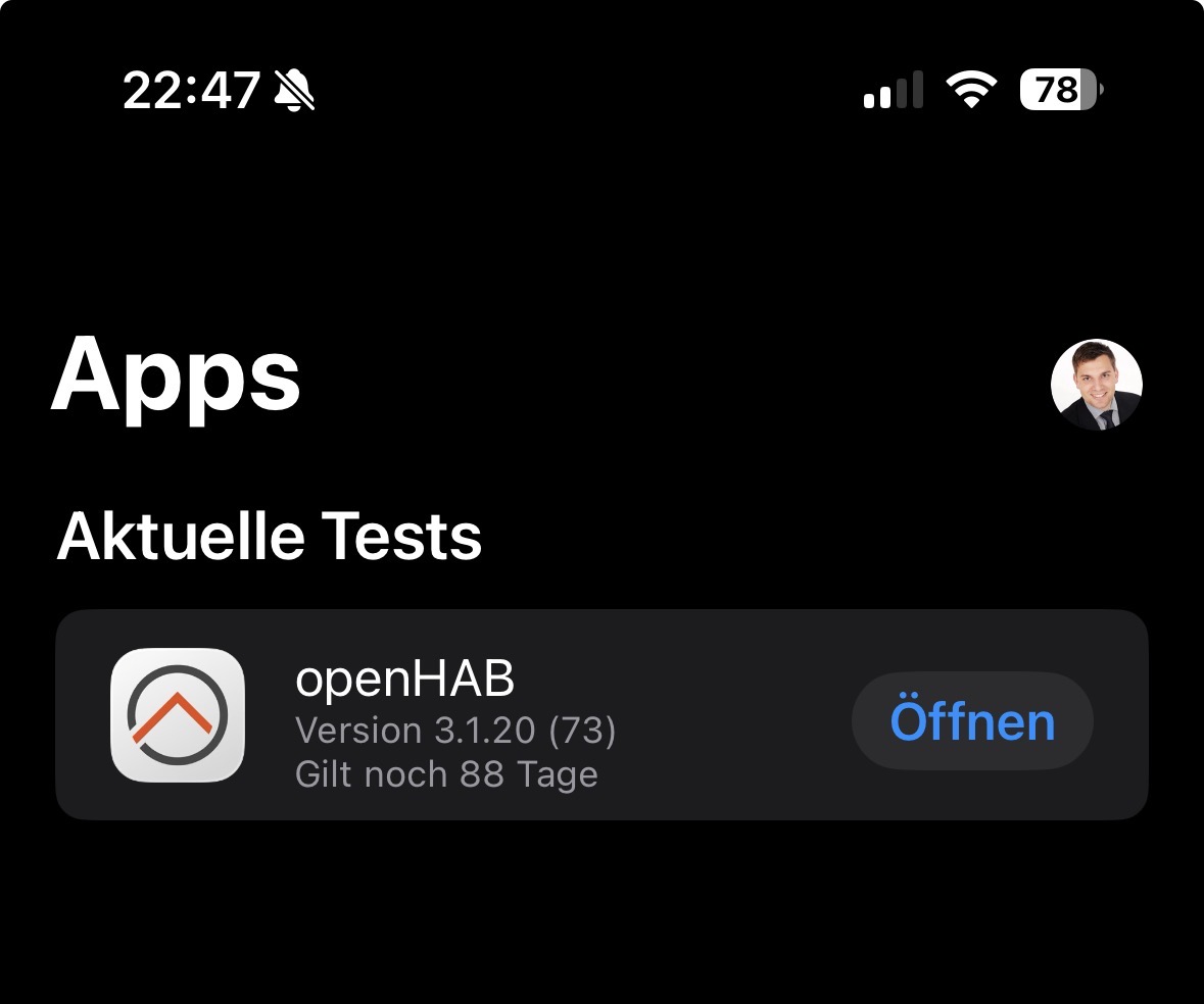

@Anpro what version of the IOS app are you on ? What version of IOS are you on (and if on 26 when did you update?) There’s been no changes to the binding or cloud, but we have been updating our test flight app often.
Hi @digitaldan,

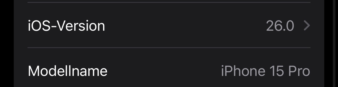

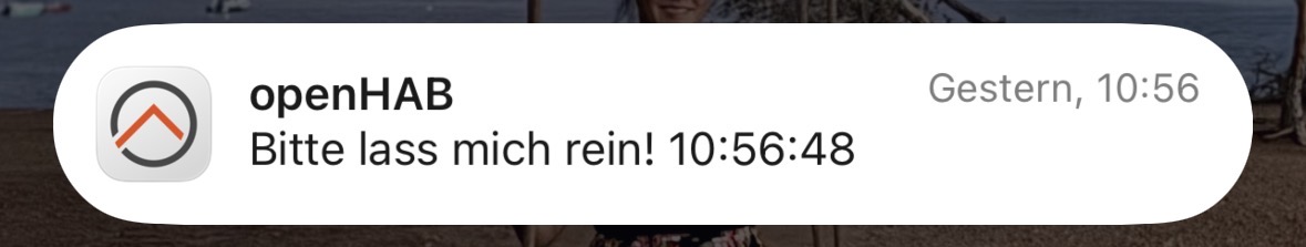

I am on iOS 26 updated the night when it came out, right before we went to Ibiza so must have been 15.09.2025 and the error occured this week on tuesday so the 23.09.2025 until then everything worked fine.
Regarding iOS App I always use the latest Beta:

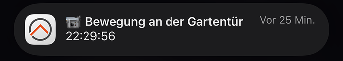

But my wife uses the regular openhab app and she faces a similar but not the exact same issue- she also does not receive the media but at least the titles still work:
