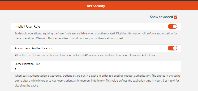

At the moment I can’t select an openhab item when creating a shortcut.
The openhab App is working fine (local and remote) and my rest api is working too.
Still not working for me either.
Can someone post a checklist of settings that need setting so I know that I’m not missing something simple?
