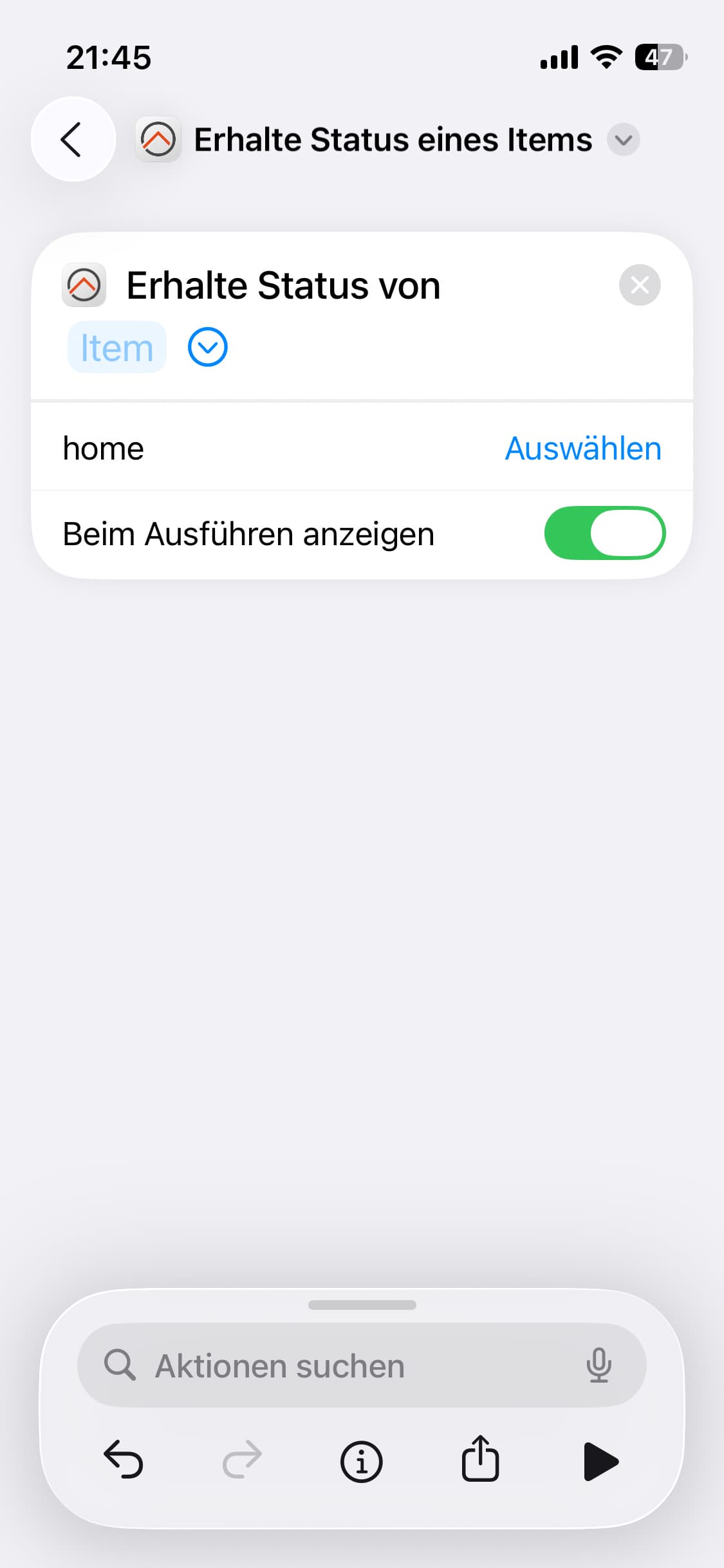

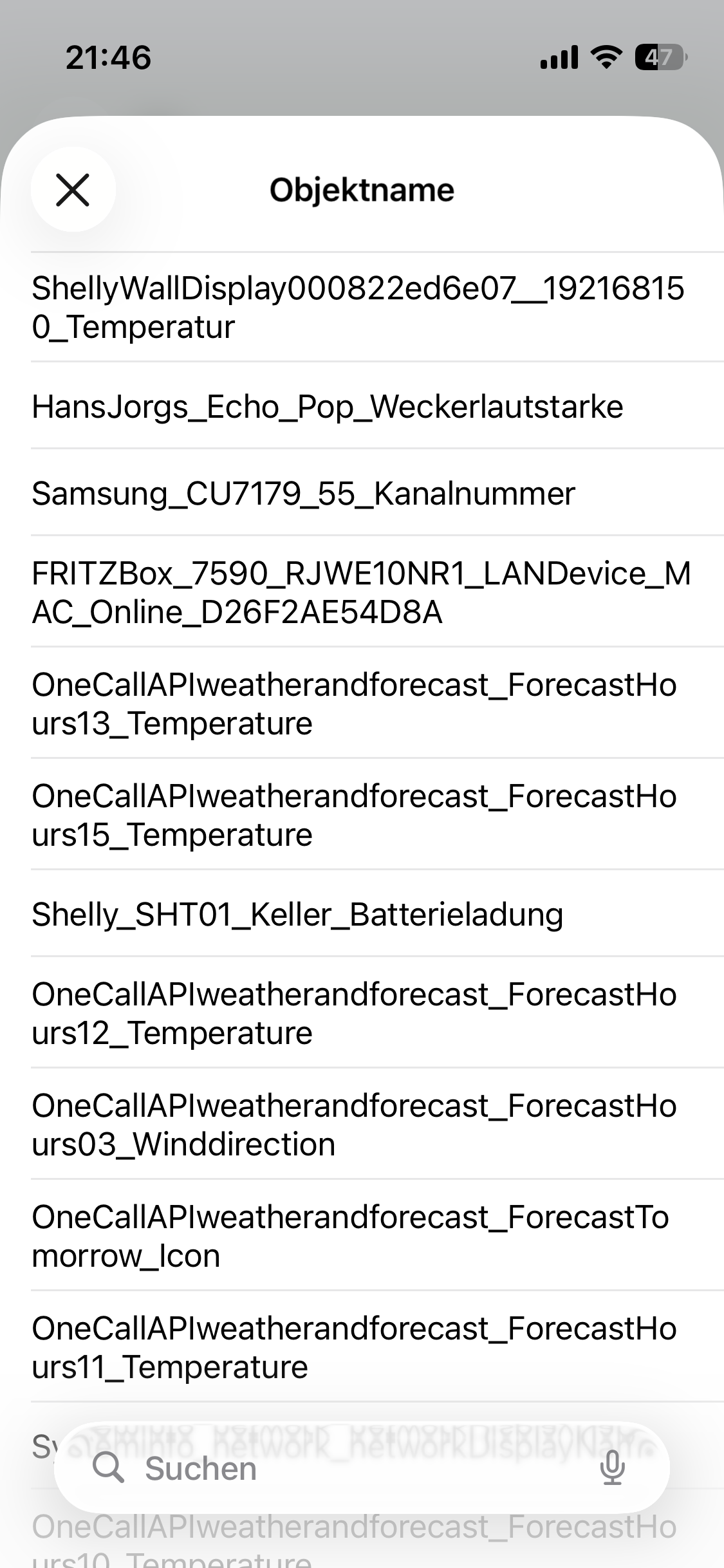

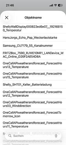

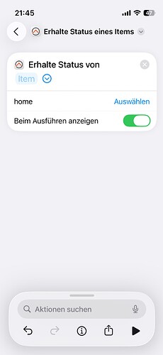

I just checked and created a new shortcut with latest testflight version (not V1).
Gave it a try and my light was switched on.
So there is no general issue I could confirm.
For completeness: iPhone 13 mini on iOS 18.01 / openHAB 4.2.0
Oh not the shortcut I meant the accessibility of making them.
How?? The items list doesn’t even populate on my end, or did you use the http method?
No, got a long list of items when pressed the items button
Edit: If it makes a difference, I am using https for local and remote access in the App.
