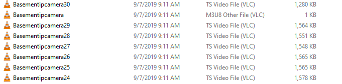

Picture of generated files in /mnt/mydisk/cameras.
Note the versions/times do not match the log file because I did additional tests after I extracted the log file, and ran a new test this morning.
Again my issue is that although HLS files are generated, they are not being displayed as a stream on my sitemap. This is true whether I open the sitemap in Safari or Chrome.

The logs show your setup is only doing 1.08 speed and you need to reach 1 to do real-time. It may be your USB bottleneck which if you use. A RAM disk like I do it may then work or it may be the cpu. I am using a odroid c2 to do my streaming and use it multiple times a day to stream a baby monitor to our tv or google home hub screen.
Thanks for the insights and analysis. I may try the RAM option described in the documentation, but it is probably the Rpi3. I have been concerned with its power with video. I’ll mark this as a solution since it is probably one or the other.
