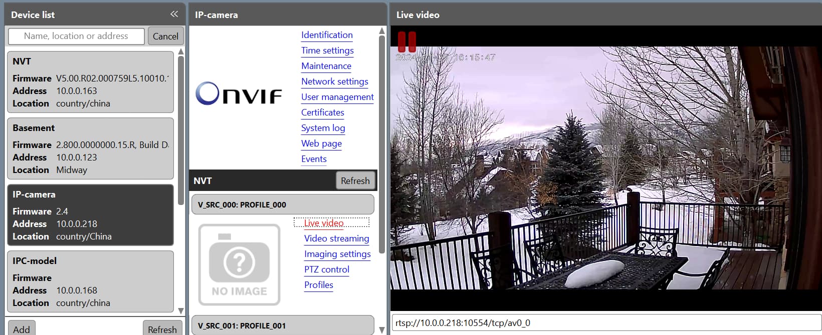

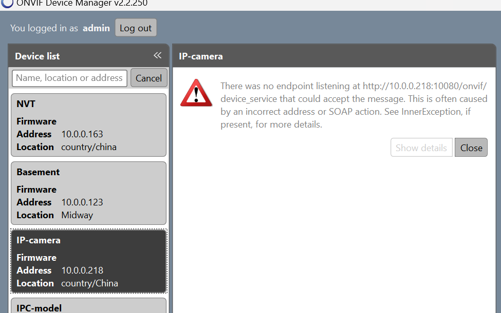

I am onsite and tried the ONVIF Device Manager program. It finds the camera on the network, but is unable to connect to it:
I have reached out to their customer service with this information and will share what they tell me.

I’m back on site. I was able to connect to the camera with the ONVIF Device Manager
I looked at the response to the ONVIF GetSnapshotUrl command and although I don’t pretend to understand all of the response, I think it specified a different port than what I had tried earlier.
<s:Body><trt:GetSnapshotUriResponse><trt:MediaUri><tt:Uri>http://10.0.0.218:61682/snapshot.cgi</tt:Uri><tt:InvalidAfterConnect>false</tt:InvalidAfterConnect><tt:InvalidAfterReboot>false</tt:InvalidAfterReboot><tt:Timeout>PT5S</tt:Timeout></trt:MediaUri></trt:GetSnapshotUriResponse></s:Body></s:Envelope>
entering http:10.0.0.218:61682/snapshot.cgi still returns 10.0.0.281 Refuses to connect.
I wonder if I need to somehow provide my username and password.
It seems promising that the ONVIF Device Manager is able to connect. Any suggestion for what I can do to further troubleshoot this?
Also,
The response is: The Site Cannot be Reached
10.0.0.218 took too long to respond.
you will need to tell the binding to use port 61682
Interesting that your earlier log showed this in the TRACE.. It is port 34730 here. It is possible your camera opens a random port each time an ONVIF program connects.
This should be considered a bug in the binding. The ONVIF is clearly stating the URL with a port to use and the binding is not doing this, so it is a bug. Thanks for finding this.
