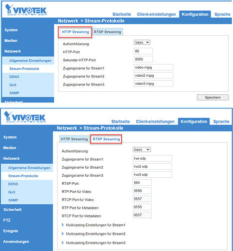

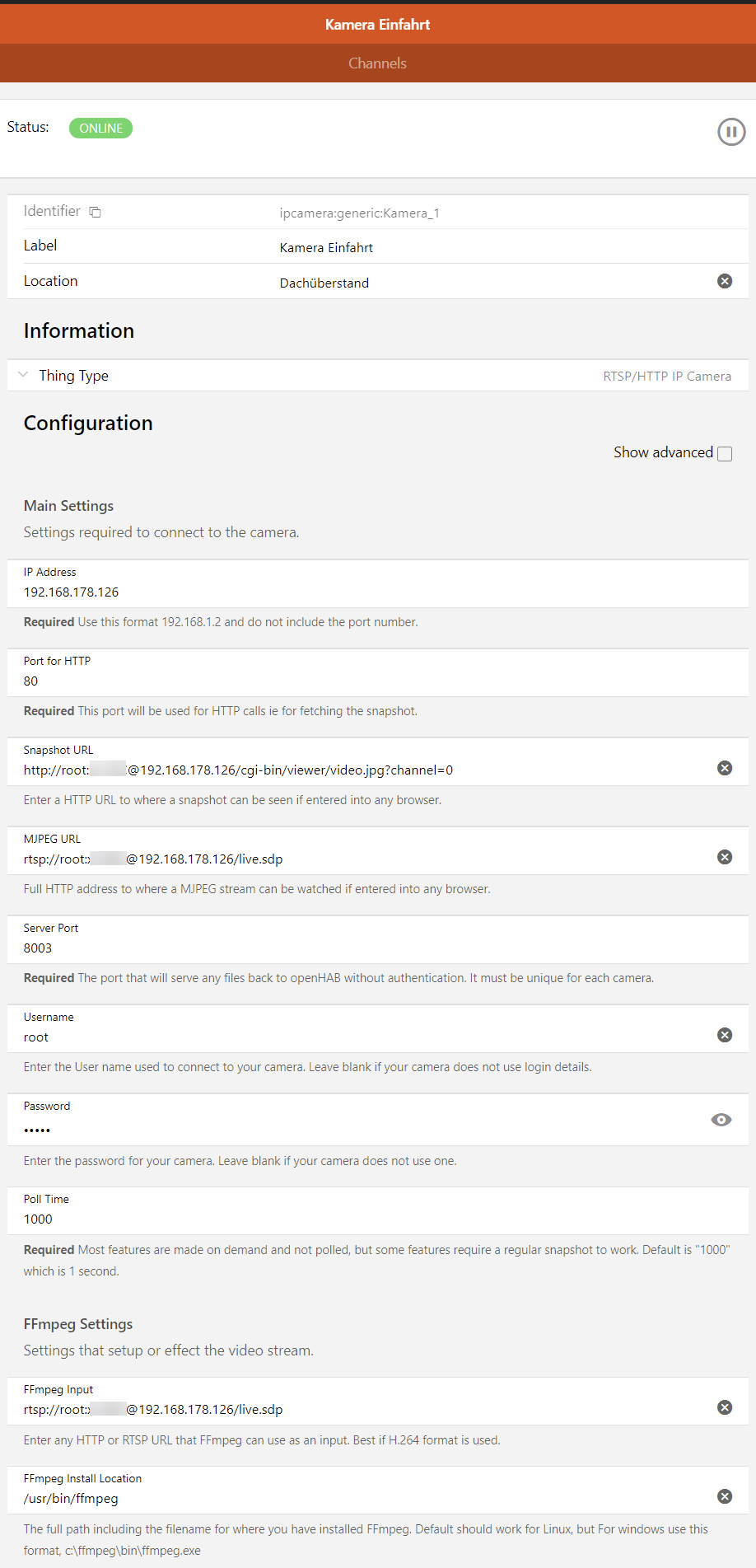

Maybe someone can help me to find the error. Here are some screenshots from my camera, binding conf and log:
Camera:
Binding:
The stream URL (rtsp://root:*****@192.168.178.126/live.sdp) is working (tested in VLC).
The generated image URL (http://192.168.178.10:8090/ipcamera.jpg) is working in the browser.
The video URL (http://192.168.178.10:8090/ipcamera.mjpeg) not!

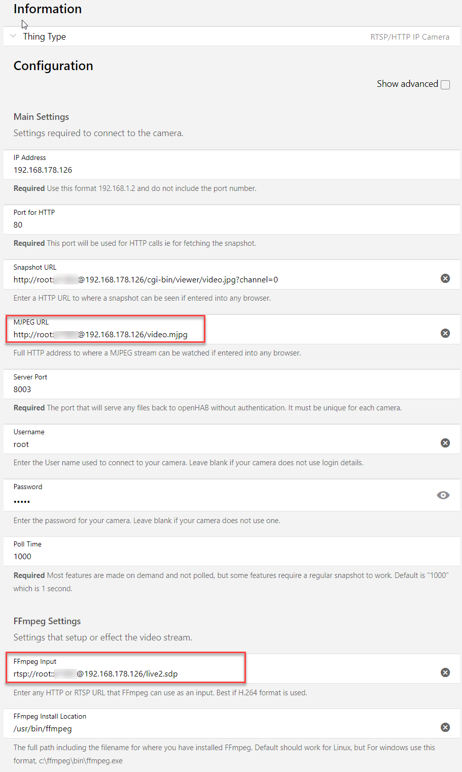

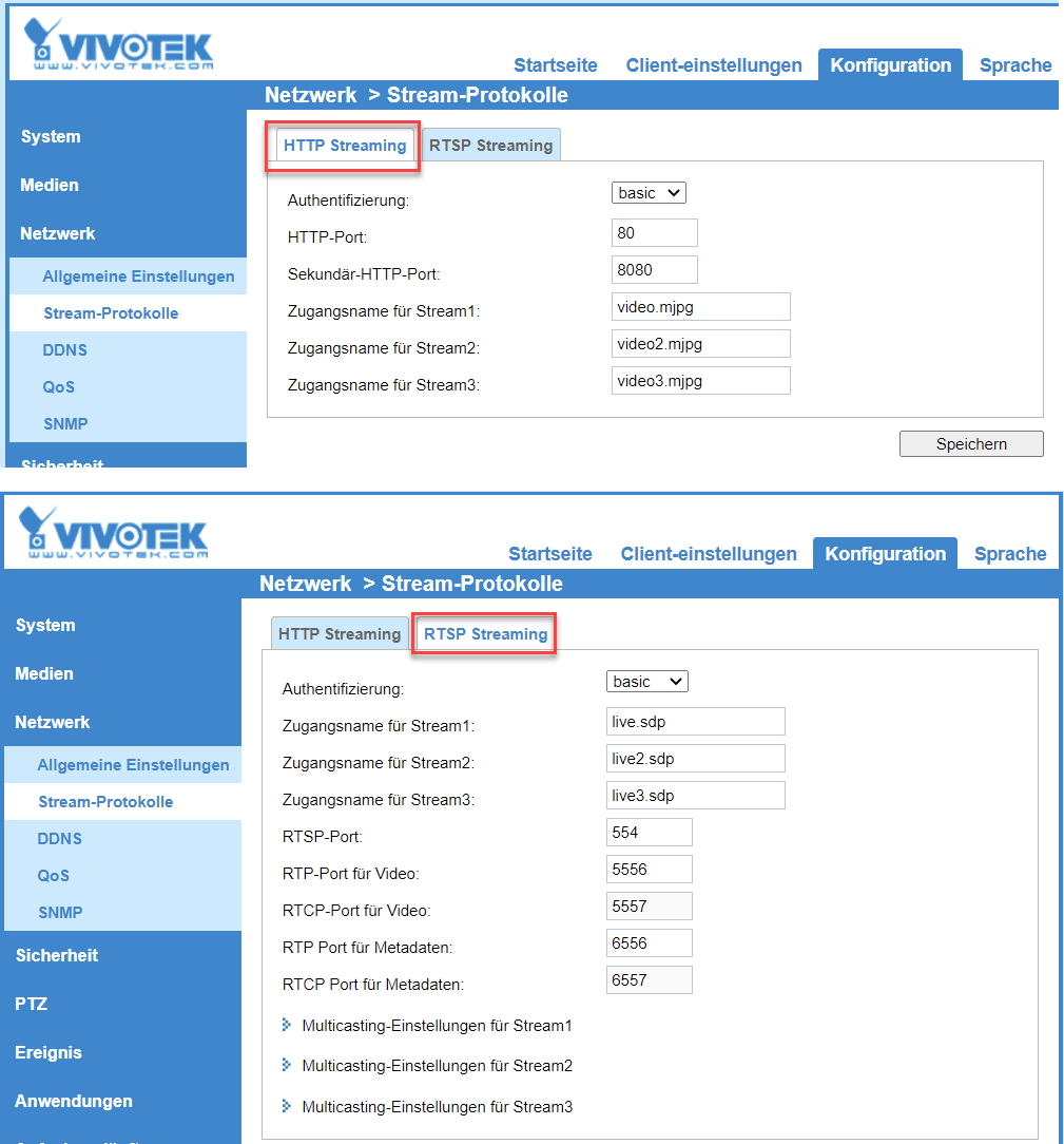

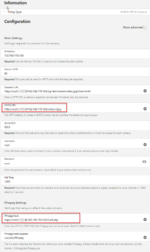

BTW, if you have a mjpeg url make sure you give it to the binding in the config field labelled “MJPEG URL”, this way when you call for the ipcamera.mjpeg stream it will proxy that url. The reason to do this would be if your camera only allows 1-2 streams at the same time and you want to have 4+ tablets and phones looking at the stream. If the camera supports enough, then it is always better to stream direct from the camera to the end devices and not go through the binding, but it hurts nothing to set it up in case you want it.
Yes I a have both MJPG and RTSP and I customized it that way:
