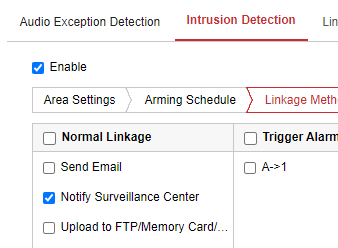

Do u have the alarms ticked to notify the surveillance centre? You may have none ticked in the cameras web setup pages.
I know this has been asked a lot but this binding seems to be getting better and better with a lot of changes being made very quickly.
How do people have their reolink rlc 410 setup? Do you still use the http/rtsp or basic onvif?
Has anyone gotten the motion alarms to work thats mainly what I’m worried about?
Definitely wish i would have saw this binding before i bought reolink and gone with amcrest, only reason I didn’t is because of the displaying on chromecasts.
Yes :
But still see the messages

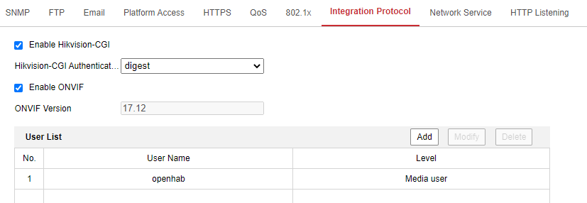

The CGI / API is disabled by default on Hikvision cameras, you need to enable it, see…
Hi matt1,
I read it and it’s already activated
Then look at the log in TRACE mode.
Get the URL from the log and test it in any browser.
Contact support for the camera if it does not work in a browser.

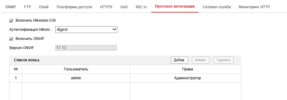

Sorry for the screen in Russian, but disable basic authorization and add the user to the table below.

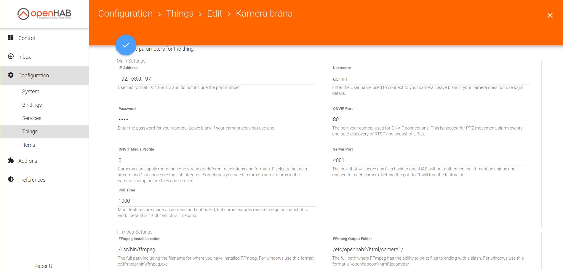

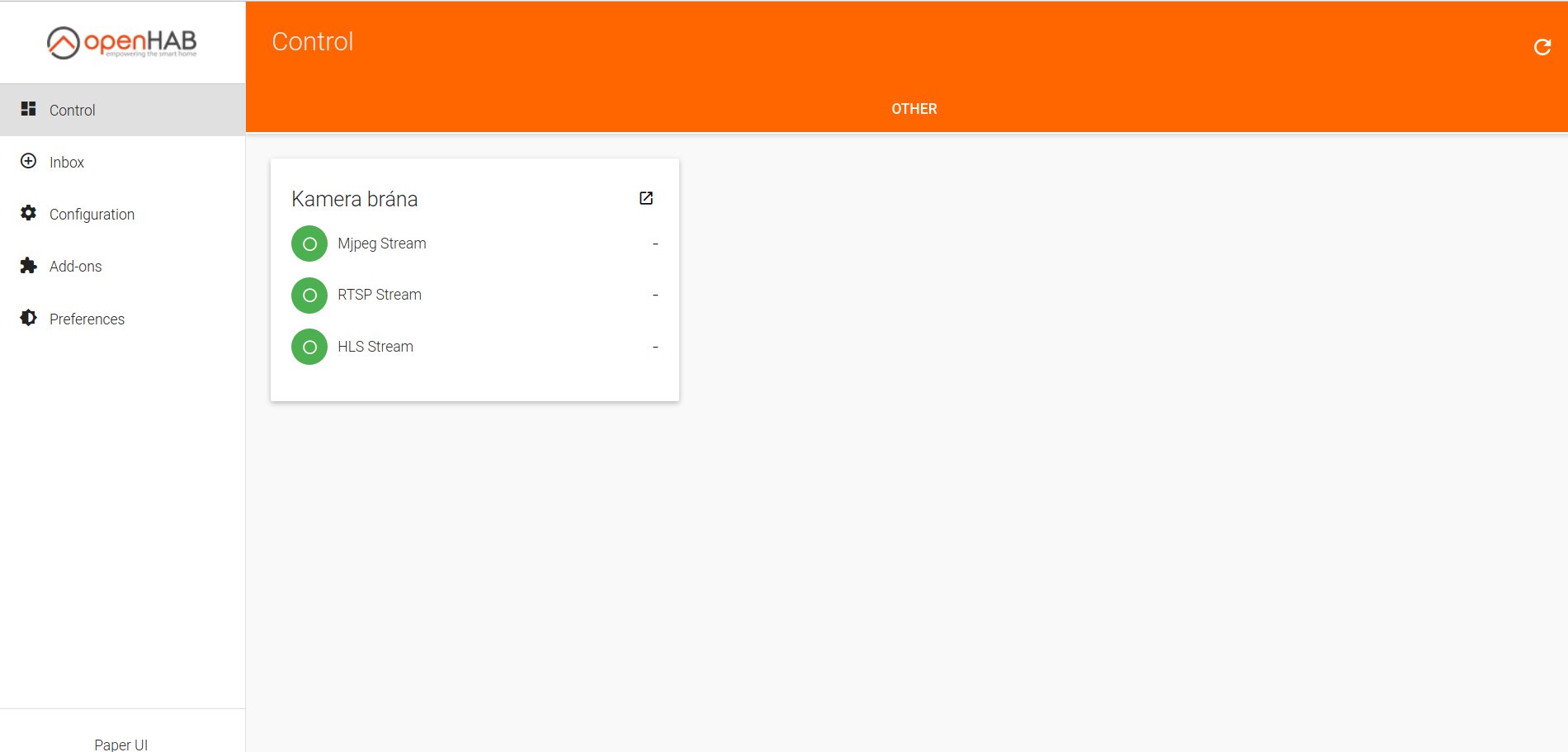

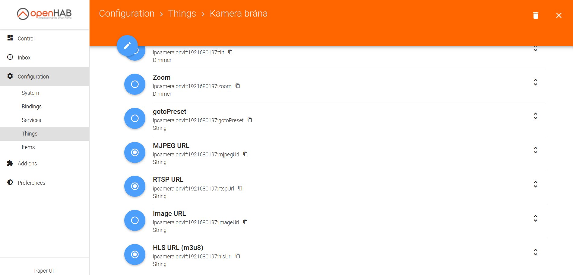

Hello, I’m bought Digoo dg-zxc40 camera but I don’t know how to setup using IP camera binding - onvif. Openhab found the camera,but it is all. Nothing works. The camera supports onvif and in Things is online. When I install Android app, no official app, but altarnative with onvif, camera works fine..
Need a little more info and this link covers what you need to do.
I I’m trying to set through Paper UI.
what happens when you try and open this URL in any browser?
http://openhab:4001/ipcamera.jpg
Replace openhab with the IP or hostname of the openhab server.
If you don’t see a picture when you open the above URL, then see my previous post and follow the advice to:
a) get some trace logs
b) open a new thread.
If you do see a picture, you just need to learn how to use sitemaps or habpanel as a picture will not show in PaperUI.
Thanks for your help but still the same issue
Try using an ADMIN level user, yours is set to ‘Media user’. I tried to use a lower rights once and it did not work. Also since the binding can turn off alarms it probably needs to be above a user that can only view the stream.
