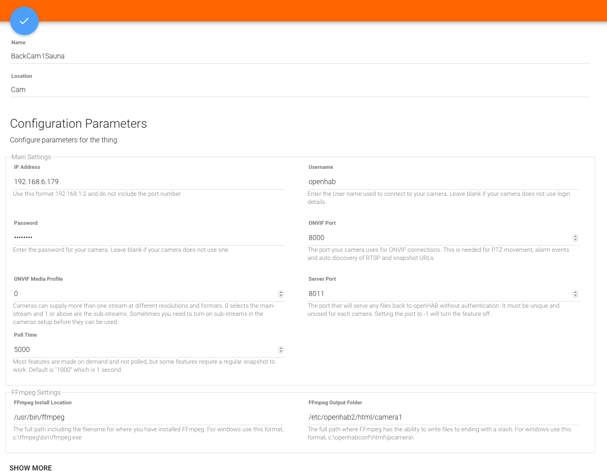

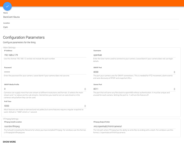

Anything to fine tune?
How to get the timestamp for the last alarm / motion events?
OH is 2.5.12 with latest ipcamera build from Jenkins, freshly installed ffmpeg
Settings:
