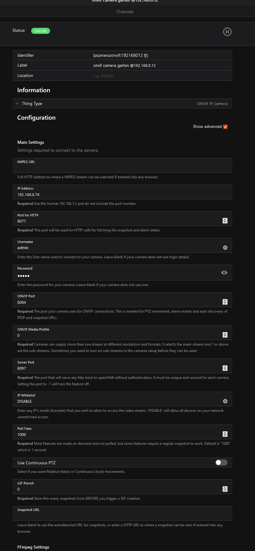

Hello
I created the Thing and the items entirely through the openhab ui, so there are no thing or item files I could share.
However, the json code of the thing looks as below.
I did see the same error message and it disappeared once I got the serverPort right. It is important that it is not blocked by any firewall.
It’s also a good idea to increase the log level of the ipcamera binding to trace because then you see the results of the onvif discovery.
Also, the ffmpegOutput must be a directory where openhab has full access. And yes, I think you do need to install ffmpeg for streaming.
UID: ipcamera:dahua:1921681153
label: PTZ North
thingTypeUID: ipcamera:dahua
configuration:
mjpegOptions: -q:v 5 -r 2 -vf scale=1920:1080 -update 1
ipAddress: 192.168.1.153
updateImageWhen: “0”
mjpegUrl: ffmpeg
onvifPort: 80
gifPreroll: 0
ffmpegLocation: /usr/bin/ffmpeg
serverPort: 8081
ffmpegOutput: /etc/openhab/html/camera1/
ipWhitelist: DISABLE
mp4OutOptions: -c:v copy -c:a copy
pollTime: 1000
password:
port: 80
nvrChannel: 1
snapshotOptions: -an -vsync vfr -q:v 2 -update 1
ptzContinuous: false
onvifMediaProfile: 0
hlsOutOptions: -strict -2 -f lavfi -i aevalsrc=0 -acodec aac -vcodec copy
-hls_flags delete_segments -hls_time 2 -hls_list_size 4
gifOutOptions: -r 2 -filter_complex
scale=-2:360:flags=lanczos,setpts=0.5*PTS,split[o1][o2];[o1]palettegen[p];[o2]fifo[o3];[o3][p]paletteuse
username: admin
location: Outdoors
