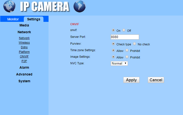

Hello!
I have an IP Camera that support ONVIF as in the picture,
2018-07-03 16:35:33.008 [.ItemChannelLinkAddedEvent] - Link 'ipcamera_ONVIF_acadd52a_updateImageNow-ipcamera:ONVIF:acadd52a:updateImageNow' has been added.
2018-07-03 16:35:33.026 [.ItemChannelLinkAddedEvent] - Link 'ipcamera_ONVIF_acadd52a_image-ipcamera:ONVIF:acadd52a:image' has been added.
2018-07-03 16:35:33.043 [.ItemChannelLinkAddedEvent] - Link 'ipcamera_ONVIF_acadd52a_pan-ipcamera:ONVIF:acadd52a:pan' has been added.
2018-07-03 16:35:33.053 [.ItemChannelLinkAddedEvent] - Link 'ipcamera_ONVIF_acadd52a_tilt-ipcamera:ONVIF:acadd52a:tilt' has been added.
2018-07-03 16:35:33.062 [.ItemChannelLinkAddedEvent] - Link 'ipcamera_ONVIF_acadd52a_zoom-ipcamera:ONVIF:acadd52a:zoom' has been added.
2018-07-03 16:35:33.071 [.ItemChannelLinkAddedEvent] - Link 'ipcamera_ONVIF_acadd52a_videourl-ipcamera:ONVIF:acadd52a:videourl' has been added.
2018-07-03 16:35:33.081 [.ItemChannelLinkAddedEvent] - Link 'ipcamera_ONVIF_acadd52a_imageurl-ipcamera:ONVIF:acadd52a:imageurl' has been added.
2018-07-03 16:35:33.124 [hingStatusInfoChangedEvent] - 'ipcamera:ONVIF:acadd52a' changed from UNINITIALIZED to INITIALIZING
2018-07-03 16:35:33.141 [INFO ] [ing.ipcamera.handler.IpCameraHandler] - About to connect to the IP Camera using the ONVIF PORT at IP:192.168.1.49:80
2018-07-03 16:35:33.221 [ERROR] [l.internal.messaging.saaj.client.p2p] - SAAJ0008: Bad Response; Not Found
2018-07-03 16:35:33.223 [WARN ] [ing.ipcamera.handler.IpCameraHandler] - SOAP error when trying to connect with ONVIF. This may indicate your camera does not fully support ONVIF, check for an updated firmware for your camera. Will try and connect with HTTP. Camera at IP:192.168.1.49, fault was com.sun.xml.internal.messaging.saaj.SOAPExceptionImpl: com.sun.xml.internal.messaging.saaj.SOAPExceptionImpl: Bad response: (404Not Found
2018-07-03 16:35:33.225 [ERROR] [ing.ipcamera.handler.IpCameraHandler] - Camera failed to report a valid Snaphot URL, try over-riding the Snapshot URL auto detection by entering a known URL.
2018-07-03 16:35:33.238 [hingStatusInfoChangedEvent] - 'ipcamera:ONVIF:acadd52a' changed from INITIALIZING to OFFLINE (CONFIGURATION_ERROR): Camera failed to report a valid Snaphot URL, try over-riding the Snapshot URL auto detection by entering a known URL.
2018-07-03 16:36:37.123 [INFO ] [ing.ipcamera.handler.IpCameraHandler] - About to connect to the IP Camera using the ONVIF PORT at IP:192.168.1.49:80
2018-07-03 16:36:37.221 [ERROR] [l.internal.messaging.saaj.client.p2p] - SAAJ0008: Bad Response; Not Found
2018-07-03 16:36:37.223 [WARN ] [ing.ipcamera.handler.IpCameraHandler] - SOAP error when trying to connect with ONVIF. This may indicate your camera does not fully support ONVIF, check for an updated firmware for your camera. Will try and connect with HTTP. Camera at IP:192.168.1.49, fault was com.sun.xml.internal.messaging.saaj.SOAPExceptionImpl: com.sun.xml.internal.messaging.saaj.SOAPExceptionImpl: Bad response: (404Not Found
2018-07-03 16:36:37.225 [ERROR] [ing.ipcamera.handler.IpCameraHandler] - Camera failed to report a valid Snaphot URL, try over-riding the Snapshot URL auto detection by entering a known URL.
2018-07-03 16:37:41.122 [INFO ] [ing.ipcamera.handler.IpCameraHandler] - About to connect to the IP Camera using the ONVIF PORT at IP:192.168.1.49:80
2018-07-03 16:37:41.209 [ERROR] [l.internal.messaging.saaj.client.p2p] - SAAJ0008: Bad Response; Not Found
2018-07-03 16:37:41.216 [WARN ] [ing.ipcamera.handler.IpCameraHandler] - SOAP error when trying to connect with ONVIF. This may indicate your camera does not fully support ONVIF, check for an updated firmware for your camera. Will try and connect with HTTP. Camera at IP:192.168.1.49, fault was com.sun.xml.internal.messaging.saaj.SOAPExceptionImpl: com.sun.xml.internal.messaging.saaj.SOAPExceptionImpl: Bad response: (404Not Found
2018-07-03 16:37:41.223 [ERROR] [ing.ipcamera.handler.IpCameraHandler] - Camera failed to report a valid Snaphot URL, try over-riding the Snapshot URL auto detection by entering a known URL.
2018-07-03 16:38:45.122 [INFO ] [ing.ipcamera.handler.IpCameraHandler] - About to connect to the IP Camera using the ONVIF PORT at IP:192.168.1.49:80
2018-07-03 16:38:45.192 [ERROR] [l.internal.messaging.saaj.client.p2p] - SAAJ0008: Bad Response; Not Found
2018-07-03 16:38:45.196 [WARN ] [ing.ipcamera.handler.IpCameraHandler] - SOAP error when trying to connect with ONVIF. This may indicate your camera does not fully support ONVIF, check for an updated firmware for your camera. Will try and connect with HTTP. Camera at IP:192.168.1.49, fault was com.sun.xml.internal.messaging.saaj.SOAPExceptionImpl: com.sun.xml.internal.messaging.saaj.SOAPExceptionImpl: Bad response: (404Not Found
2018-07-03 16:38:45.202 [ERROR] [ing.ipcamera.handler.IpCameraHandler] - Camera failed to report a valid Snaphot URL, try over-riding the Snapshot URL auto detection by entering a known URL.
2018-07-03 16:39:49.122 [INFO ] [ing.ipcamera.handler.IpCameraHandler] - About to connect to the IP Camera using the ONVIF PORT at IP:192.168.1.49:80
2018-07-03 16:39:49.194 [ERROR] [l.internal.messaging.saaj.client.p2p] - SAAJ0008: Bad Response; Not Found
2018-07-03 16:39:49.199 [WARN ] [ing.ipcamera.handler.IpCameraHandler] - SOAP error when trying to connect with ONVIF. This may indicate your camera does not fully support ONVIF, check for an updated firmware for your camera. Will try and connect with HTTP. Camera at IP:192.168.1.49, fault was com.sun.xml.internal.messaging.saaj.SOAPExceptionImpl: com.sun.xml.internal.messaging.saaj.SOAPExceptionImpl: Bad response: (404Not Found
2018-07-03 16:39:49.205 [ERROR] [ing.ipcamera.handler.IpCameraHandler] - Camera failed to report a valid Snaphot URL, try over-riding the Snapshot URL auto detection by entering a known URL.
2018-07-03 16:40:53.122 [INFO ] [ing.ipcamera.handler.IpCameraHandler] - About to connect to the IP Camera using the ONVIF PORT at IP:192.168.1.49:80
2018-07-03 16:40:53.199 [ERROR] [l.internal.messaging.saaj.client.p2p] - SAAJ0008: Bad Response; Not Found
2018-07-03 16:40:53.202 [WARN ] [ing.ipcamera.handler.IpCameraHandler] - SOAP error when trying to connect with ONVIF. This may indicate your camera does not fully support ONVIF, check for an updated firmware for your camera. Will try and connect with HTTP. Camera at IP:192.168.1.49, fault was com.sun.xml.internal.messaging.saaj.SOAPExceptionImpl: com.sun.xml.internal.messaging.saaj.SOAPExceptionImpl: Bad response: (404Not Found
2018-07-03 16:40:53.206 [ERROR] [ing.ipcamera.handler.IpCameraHandler] - Camera failed to report a valid Snaphot URL, try over-riding the Snapshot URL auto detection by entering a known URL.
You need to change the way onvif port to 8080 to match the settings of your camera. U have port 80 selected
