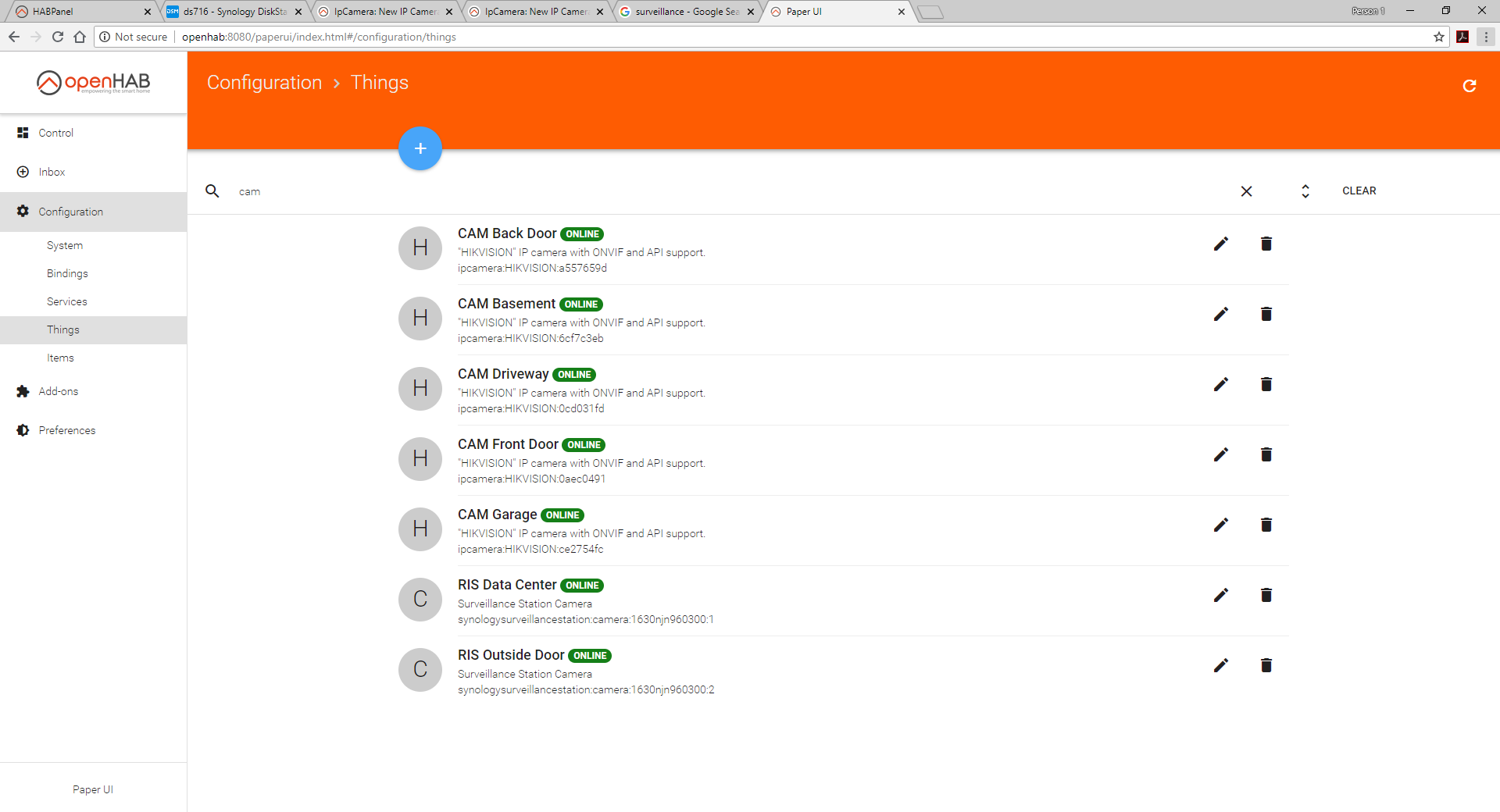

Just wanted to say thank you! and kudo’s to you on this binding!

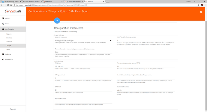

I got it running quickly with this setup:
Synology DSM 6.x running OH2.3 querying against HIKVision Model DS-7208HUI-K2
Used PaperUI to setup the 8 camera’s:

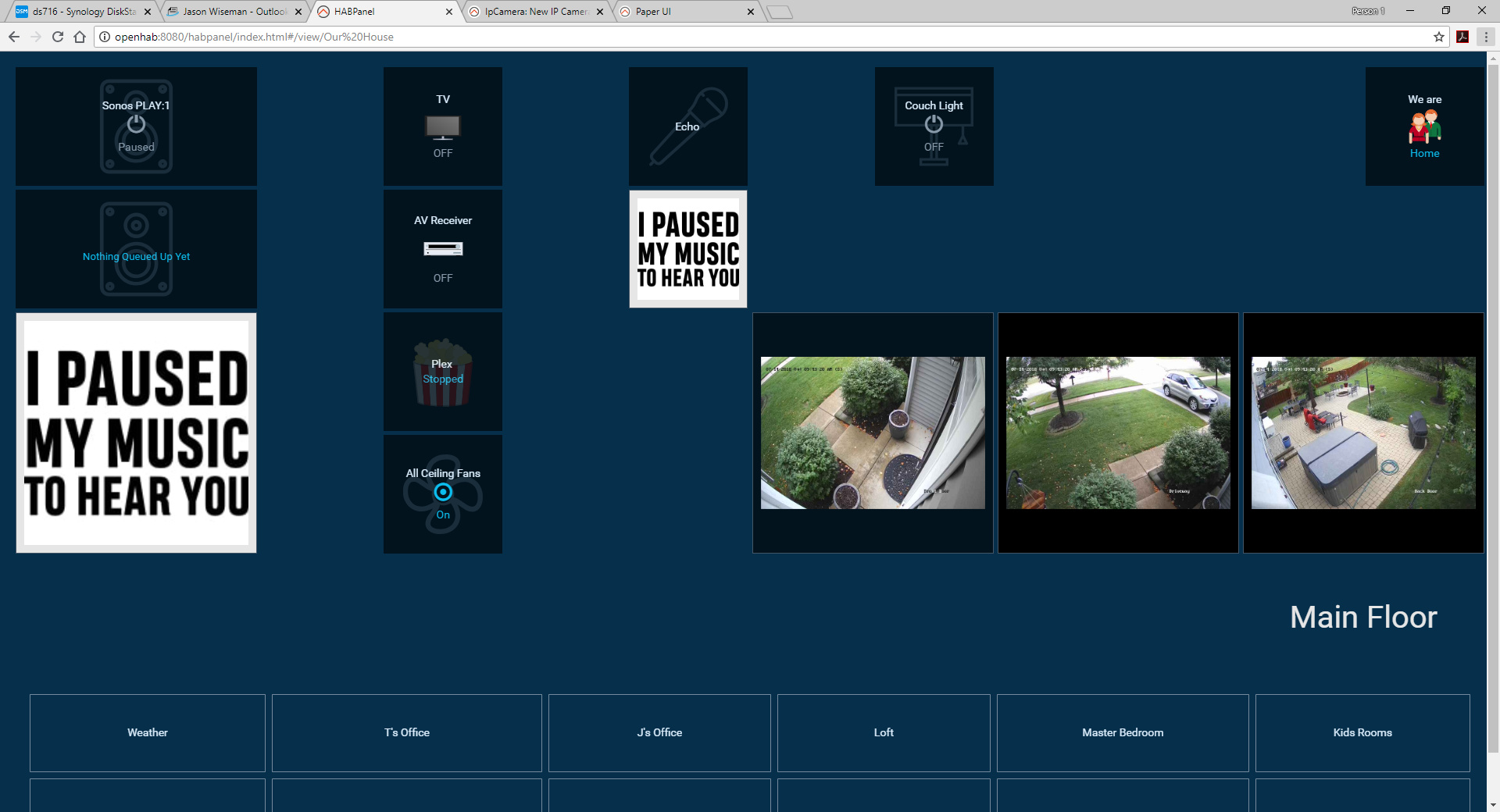

Using HabPanel to display the camera’s:
Thanks, Jay
