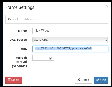

how to add video feed to HABPanel? which widget to use? sorry im totally new to this.
@techmike
Did you try the older version or use the work around? What is the contents of your things file?
@piowork
You have hit the same bug that has been discussed the last few posts, the answer is in my last post on what to do. Please ensure you clean the cache and temp folders out whenever you change the files in your addons location, search this forum for how this is done.
@Diogenes
There are different types of streams and some are easier then others to achieve. mjpeg works well but cameras usually limit the quality they can supply in this format so HLS is needed for better quality.
@Gayanll
I don’t use Habpanel much, perhaps someone else can post how they do it. Snapshots at 1fps work via the image widget, mjpeg from memory works I just have not fully worked out how to do HLS streams just yet. You would need to use the template widget and add some code for the HLS to display and I half got it working a while back and would need to take a look at my notes.

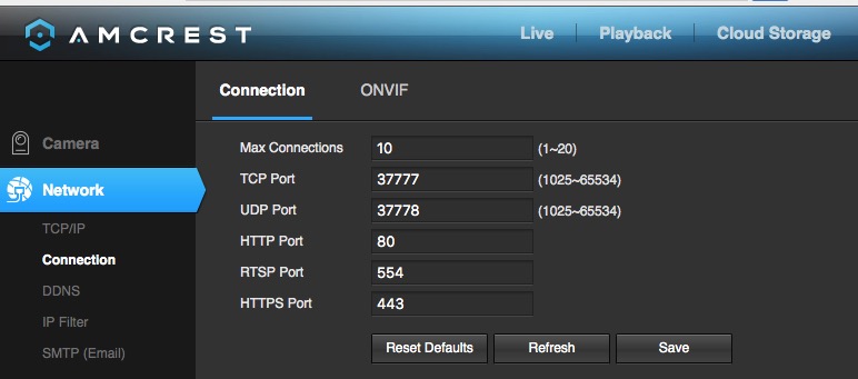

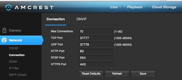

Hi @Gayanll, I use the “Frame Widget”.
Just select the “Static URL” setting and type the URL in there, in my setup it is: http://192.168.1.200:37777/ipcamera.m3u8
Please note, in order to get this to work you have to match the port setting in the IpCamera thing:
	SERVER_PORT=37777,
with your TCP port setting in the camera (shown is my Amcrest setup screen):
Hope this helps :wink:
