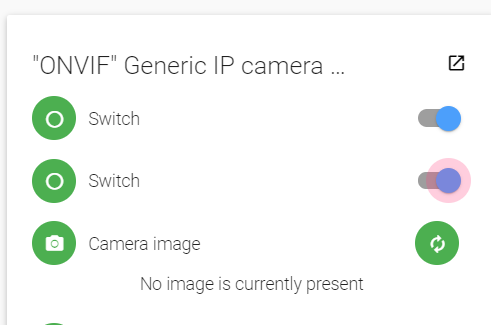

Same in basic UI
you have pressed the green refresh button to the right of Camera Image Yes? as the image shows the switch being toggled.

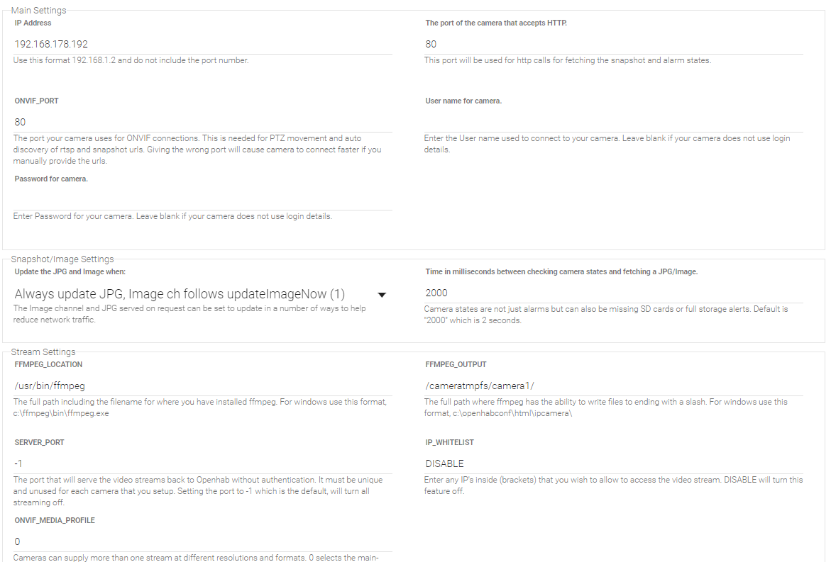

does anyone know what to enter for server_port for an Axis A8105E doorbell? Trying to configure it under paper UI

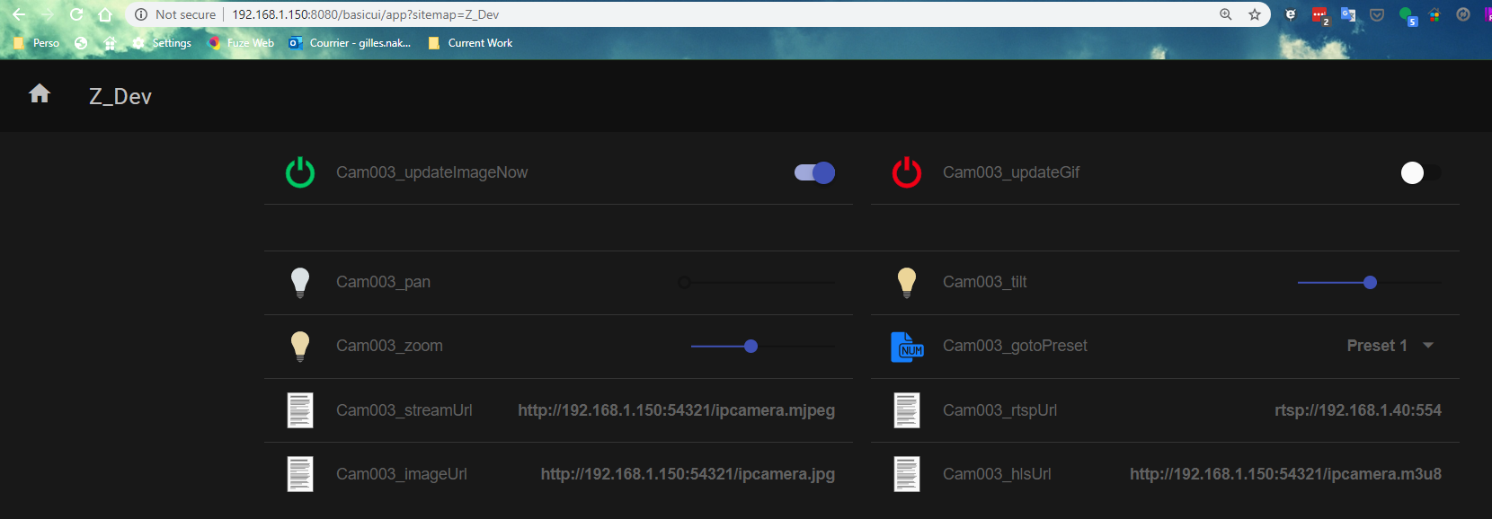

i am little bit lost. the Thing is online but no image. any help will be appreciated
My thing definition
Thing ipcamera:ONVIF:003
    IPADDRESS="192.168.1.40",
    ONVIF_PORT=80,
    PORT=80,
	SERVER_PORT=54321,
	FFMPEG_OUTPUT="/etc/openhab2/html/cameras/cam1/",
	SNAPSHOT_URL_OVERRIDE="http://192.168.1.40/onvif/snapshot",
	USERNAME="admin",
	PASSWORD="",
	POLL_CAMERA_MS=2000,
	UPDATE_IMAGE=true
My items:
Switch	Cam003_updateImageNow					{channel="ipcamera:ONVIF:003:updateImageNow"}
Switch	Cam003_updateGif						{channel="ipcamera:ONVIF:003:updateGif"}
Image	Cam003_image							{channel="ipcamera:ONVIF:003:image"}
Dimmer	Cam003_pan								{channel="ipcamera:ONVIF:003:pan"}
Dimmer	Cam003_tilt								{channel="ipcamera:ONVIF:003:tilt"}
Dimmer	Cam003_zoom								{channel="ipcamera:ONVIF:003:zoom"}
Number	Cam003_gotoPreset						{channel="ipcamera:ONVIF:003:gotoPreset"}
String	Cam003_streamUrl						{channel="ipcamera:ONVIF:003:streamUrl"}
String	Cam003_rtspUrl							{channel="ipcamera:ONVIF:003:rtspUrl"}
String	Cam003_imageUrl							{channel="ipcamera:ONVIF:003:imageUrl"}
String	Cam003_hlsUrl							{channel="ipcamera:ONVIF:003:hlsUrl"}

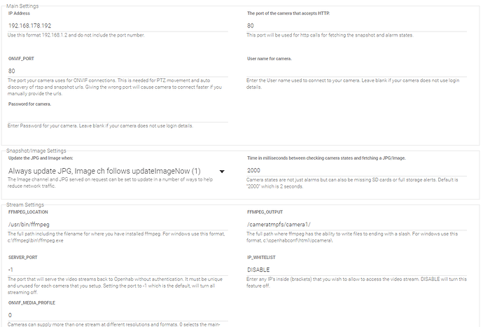

I’ve got a INQMEDIA (Chinese) IP camera that I can access through an android app called Onvifer.
The camera is detected through auto-detect and gives me the following data:
No username/password
The thing in openhab displays ONLINE, yet I can’t see an image.
Also the tilt ans pan items aren’t working. So I ghuess there’s something wrong with the thing parameters, but what am I missing?
See the readme for how to get trace level logs as only trace will show any responses back from the camera with enough detail to fault find.
