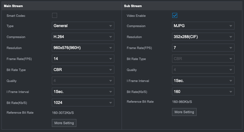

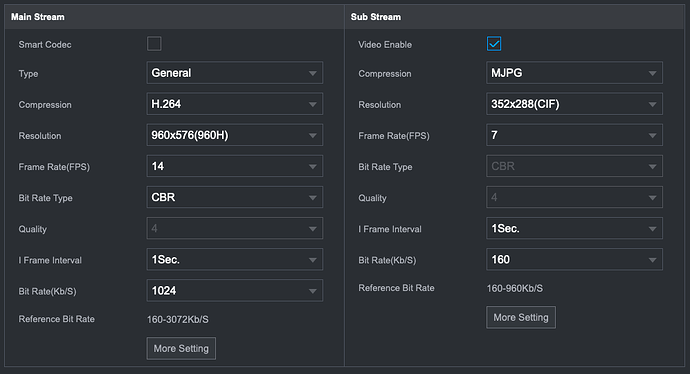

MJPEG-Stream from the binding is stopping after some time - but the snapshots-mjpeg (full-hd) stream from the binding seems to be more stable…
My dahua cam is providing a mjpeg stream (at lower resolution - about 700x400) and the cam is serving this without the need of user/password.
I may have been using webview and refresh when testing but the issue is the stream will stay stop until the next refresh comes
Around and if you refresh often you get more glitches. Not optimal like proposed solution.
Yes snapshots.mjpeg is created by the binding and does not come from the camera so interested to hear how it performs long term.

For snapshots I am aware that it’s most likely a camera thing. But I am asking if anyone has a similar NVR and knows anything.
Also… Camera seems to have the sub stream set to MJPG whenever I connect to it with the binding:
But… if I want to set it manually… there is no MJPG option at all:
How can it be set to MJPG if there is no MJPG option at all? Does the API do something weird here?
