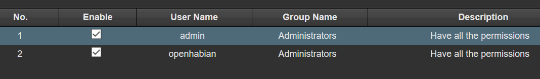

Authentication is effectively marked as show below but credentials are also configured in for the thing 001
    USERNAME="admin",
    PASSWORD="123456",
    FFMPEG_INPUT="rtsp://192.168.x.xx:554/ISAPI/Streaming/channels/401",
    ONVIF_PORT=80,
    PORT=80,
I’ve also defined a second user based on the openhab raspberry installation
