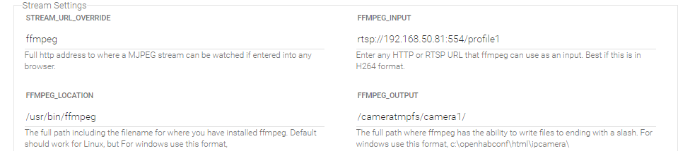

Thanks a bunch for the great binding. I currently have two Foscam ONVIF cameras working well with your binding in OpenHAB. However, I have a TrendNet IP672 which is an HTTPONLY camera which I’m having the following issue with:
I can get an MJPEG video stream to display when using HABPanel. However, I can’t seem to get a video stream to display using BasicUI and a sitemap. I’m sure it’s related to the fact that I can’t get a video stream to display when I put http://192.168.xx.xx:8059/ipcamera.mjpeg in a web browser.
Here are my HABPanel settings:

Here are some settings for the HTTPONLY (Downstairs Camera 1):
As I mentioned, the video stream plays fine in HABPanel, just not on the BasicUI. An the other ONVIF cameras are working fine in both views.
That is very interesting and nothing jumps to mind as to the cause unless it is a typo as habpanel is using the string channel directly from the binding and not from what you have typed, Tripple check they match.
The code is very different between foscam and the camera that needs ffmpeg to create the mjpeg stream from RTSP, so if there was a bug it would not effect both. The binding trys to present all cameras the same way to the user. I suggest you confirm that you have stopped the HABPanel display FIRST before trying in a browser, as the code treats the first request for the stream differently to further requests when the stream is already running. The habpanel may be blocking the browser if there is a bug.
Second thing to do is enable DEBUG and TRACE logs and watch to see if the binding is telling you it received the request for ipcamera.mjpeg and also if you see ffmpeg start up in the logs after that happens. It should also tell you when ffmpeg stops, or the stream is closing as its no longer needed.
