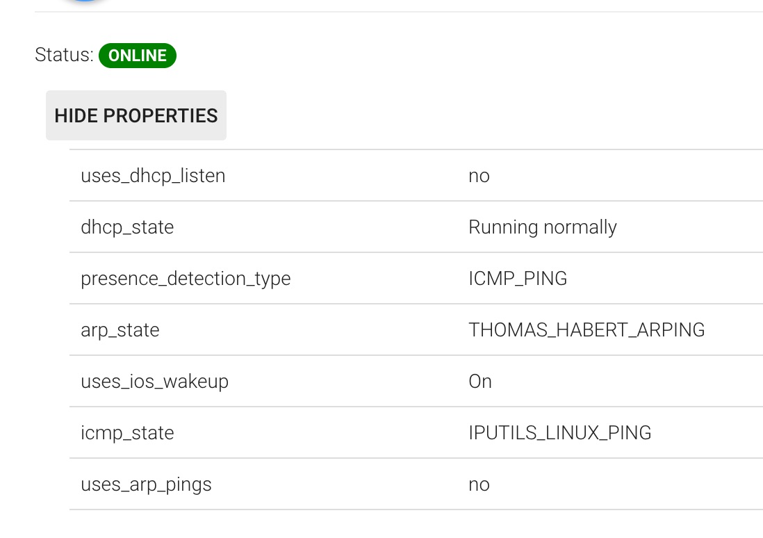

See my properties. Also for me it seems that arping is not used
@Matt77 You are using serviceDevice. Please read the description within the screenshot: …with running service.. AND …which reachable state is detected by connecting to a TCP port."
arping will never be used for a serviceDevice. Use a pingDevice instead.
Oh, that “uses_arpping” property is not existing anymore actually. Ignore what it says. The other propery says that the thomas arping was recognised and will be used.

The binding can only be as good as the tools it uses. There is unfortunately no further debug than what you see in the properties, but if it is listed there, you can be sure it is used, in parallel to everything else.
As stated already, I have only tested it with the iputils arping. iputils needs a network interface to work and I add this parameter to thomas arping as well. Might be that the program is confused because of that.
