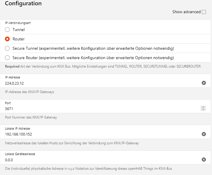

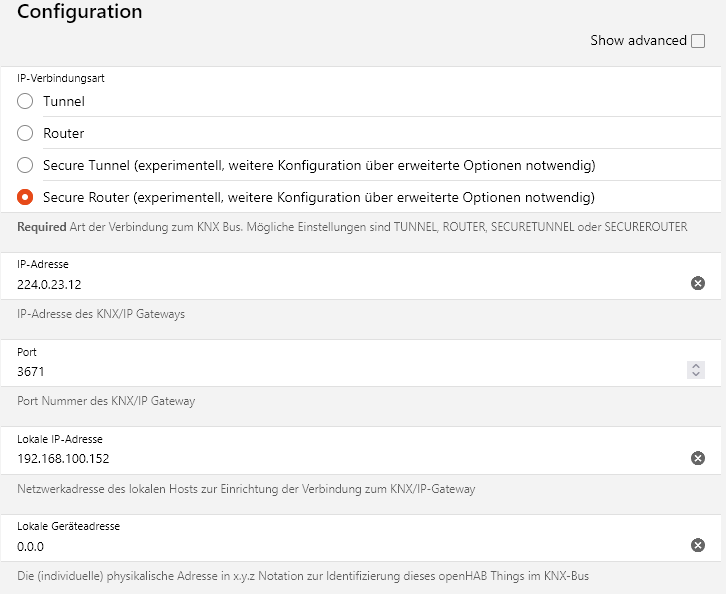

Hi, maybe I could get an helpful information about a strange behaviour with knx secure routing setup.
The MDT IP-routers are secure installed in ETS6 and are working properly. The setup in Openhab 5 is as follows.
This is also working propperly with openhab.
But whenI restart the openhab-system, alway the setup switches to “Router” and nothing is working with knx in OH.
Sometimes also the multicas adress is changing to a wrong IP.
Always I have to change that parameters manually to get it working again afer restart.
Does anybody have same experience and a possible solution to get that working properly?
Thanks a lot
Klaus
