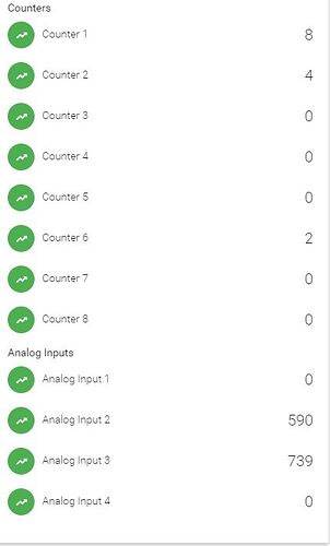

Complete Test IPX800 V3
binding GCE_2.5.8_binding (with pull on Counter & Analog)
openHAB version 2.5.8 stable
OUTPUT
Relay 1-8 → OK
Relay 9-32 → don’t find channels in the v2 binding
INPUT
Digital Input 1-8 → OK
Digital Input 9-32 → don’t find channels in the v2 binding
COUNTER
Counter 1-8 → OK
ANALOG
I test Analog channel 1, 2 e 3

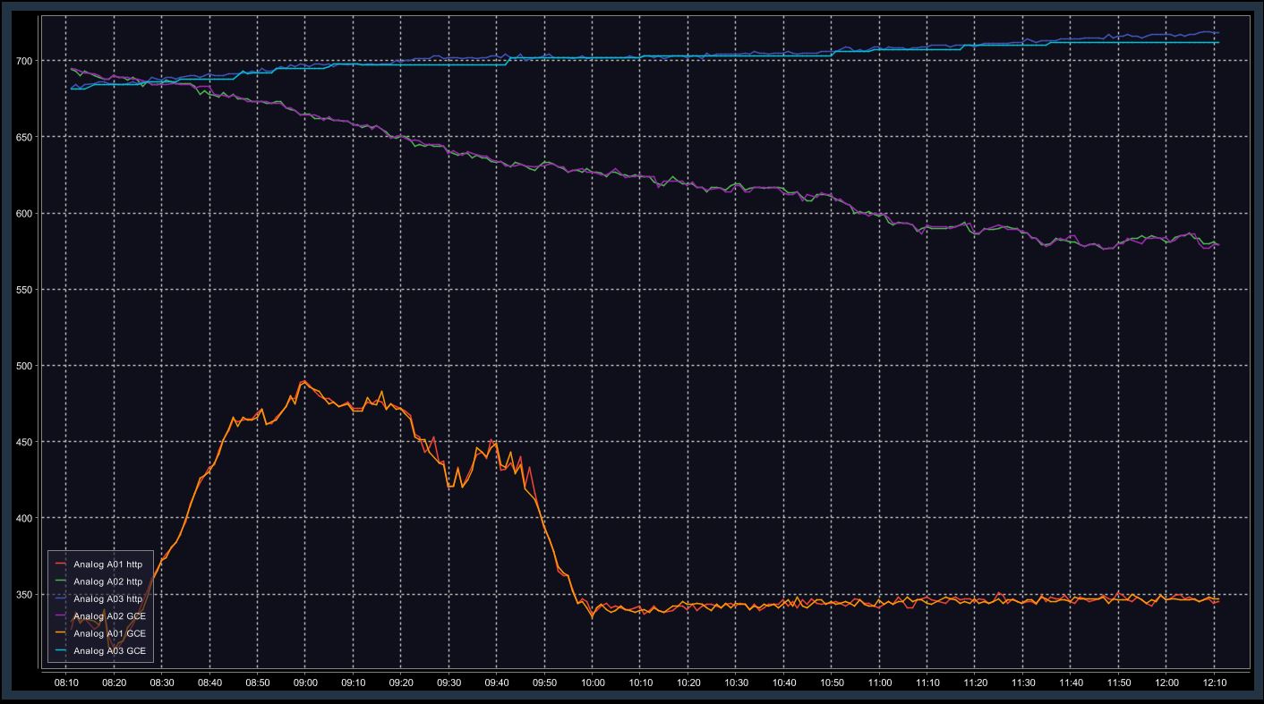

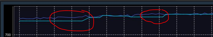

I use 2 kinds of binding: HTTP (that I already use) & GCE and create 6 ITEMS on OH linked to them.
I set pull refresh rate = 5000 (in both binding) and Histeresis = 0 for all the channel
I save the data every minute in rrd4 database

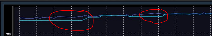

The value are similar (in my opinion little differences are due to the moment of pull request) for channels Analog_1 and Analog_2, but I seem to see a different behavior for Analog_3! Little strange, Histeresis?
@glhopital What do you think about it?
Yes, I think difference between http / gce comes from little time shift of the polling. I do not get what you point regarding A3
For inputs and outputs, I could add missing channels in the binding.
Regarding A3: I try to understand this behavior
that I did not see in A1 & A2…
I physically swapped the channels A2 with A3 , swapping the wires, and I see this behavior in A2!
There seems to be a filter in the GCE binding…but it is good: the signal is more smooth :slight_smile:
cheers

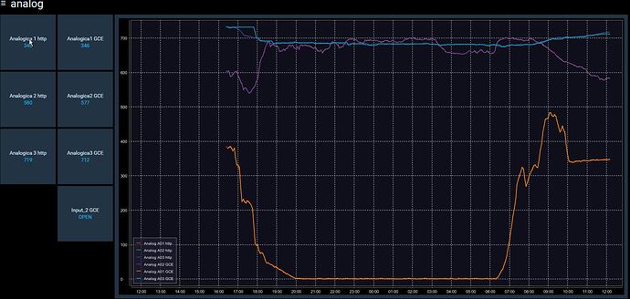

For me it looks like refresh period is not set at the same pace between the two approaches, or…could be that GCE item is an integer while HTTP item is a float ?

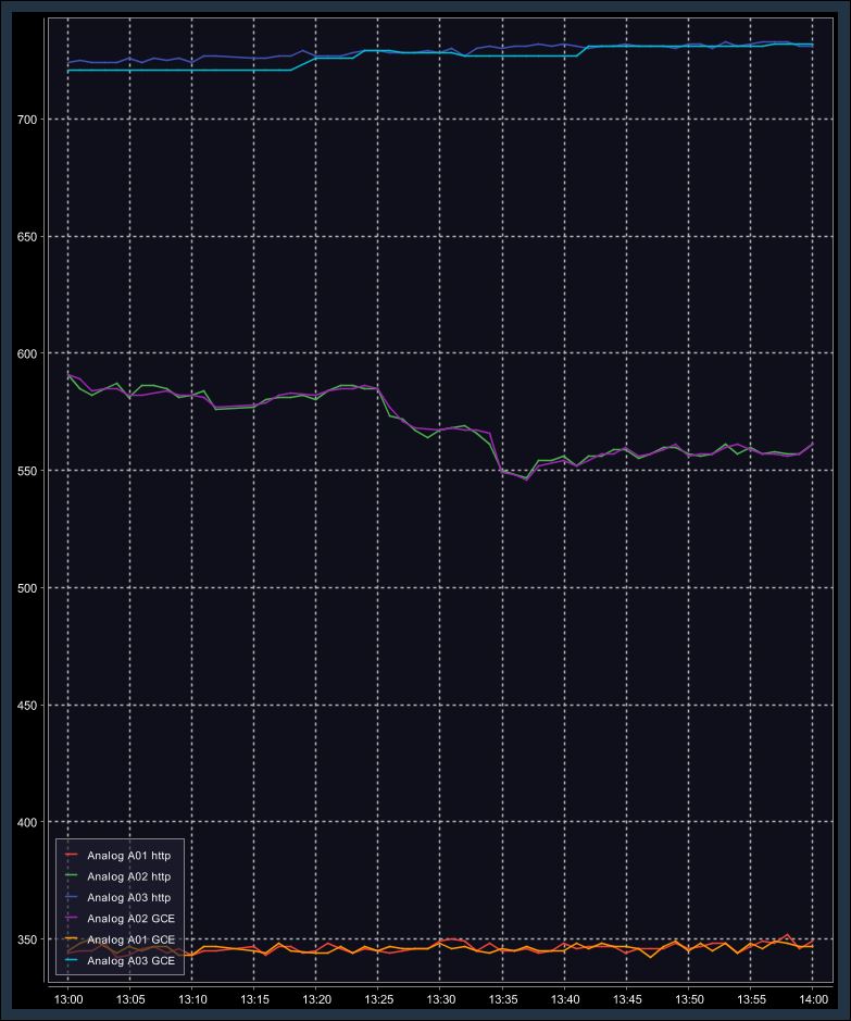

I try to set refresh period at the same pace:
HTTP binding
http.cfg
items
I don’t know very well what mean “10000” in REGEX, but changing it, the result do not change!
GCE binding
Integer vs Float
May be!!
but I don’t know where I can set it!
Maybe you can declare your http analog items as %d instead of %.1f
Hi
I declare http items as %d.. and the http & GCE items have the same behaviour.

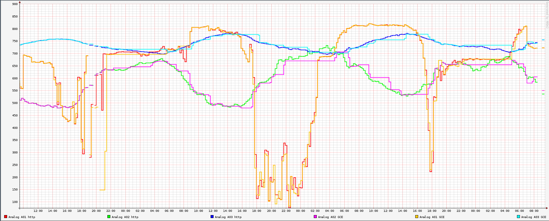

But after 2 days I see some differences
Detail
After a while channels 2 and 3 seem to stop refresh (or they refresh randomly).
I have observed the value: http value is correct with IPX800!
When you change something in IPX (es you close an input or command an output) the http & CGE value are alined.
Channel 1 is OK
