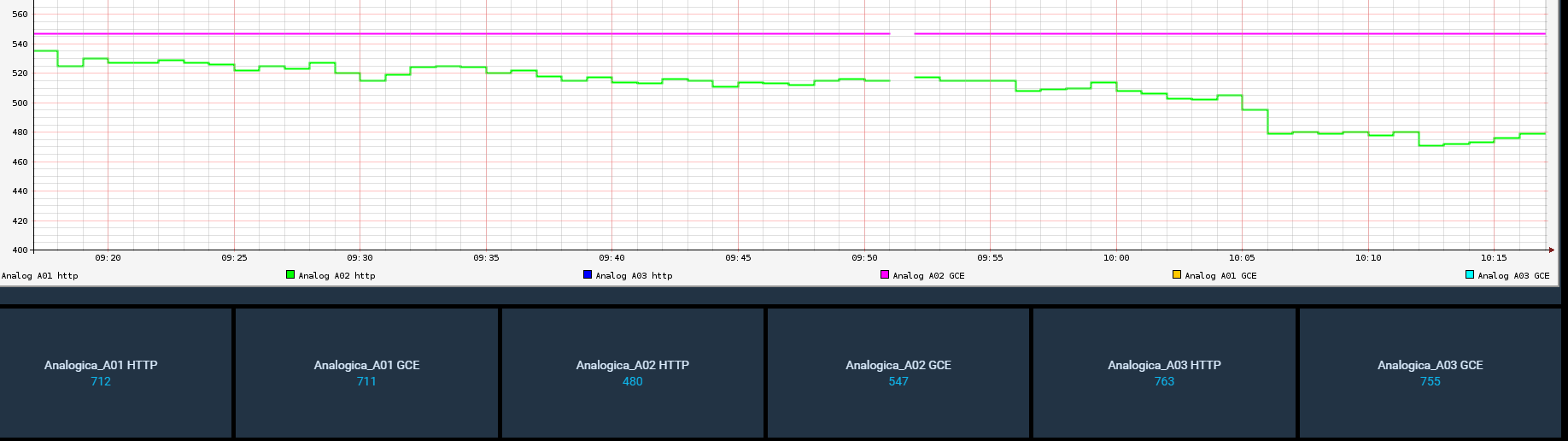

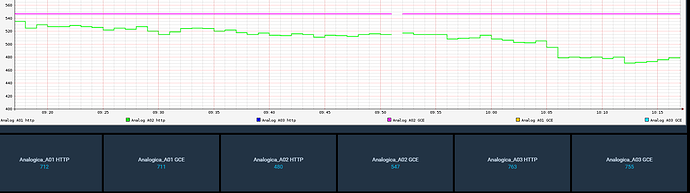

Also, regarding your graph, is the persistance definition the same between http and gce items ?
Yes, I put all the items in a Group and I put the group in persistance!
Example (situation in this moment):

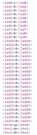

i just update my ipx800 to firmware 3.05.62 (send status is on) and i use your GCE 2.5.9 binding
When i switch an output from the ipx800 it did not “inform” the openhab, so it stay closed even if i switch it on
is it normal ?
do i have to configure something?
for the moment it seems that from openhab to IPX800 works

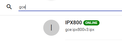

First of all, thanks for the great work, as my setup relies very much on IPX800 boxes, and the OH+GCE binding combo seems very promising for powering it.
Hence I have made a fresh install of OH3 and the version of GCE binding that comes with it, and I am having the same refresh issue : when IPX outputs are changed outside of OH, their state are not reflected in OH. Did you eventually solve the problem in OH 2 ? Am I missing some configuration work ?
