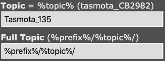

Please follow some details below:
My MQTT Configuration in Tasmota:
Sending default command via MQTT FX to test communication:

I think you’re using MQTT.fx wrong. You need to write the message/payload in the big text field underneath the topic, I think.
(I use MQTT Explorer, but I think they’re similar)
You are right!
I was sending the command on TOPIC instead of payload.
Thank you very much!!!
