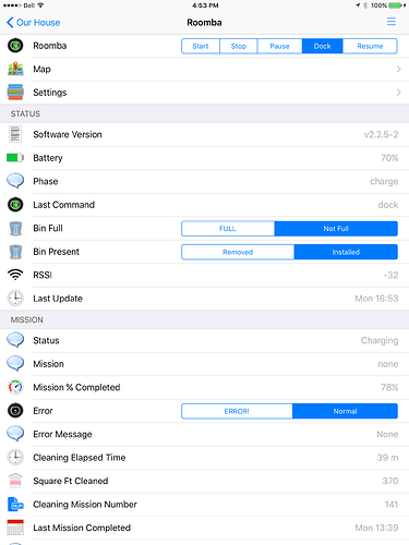

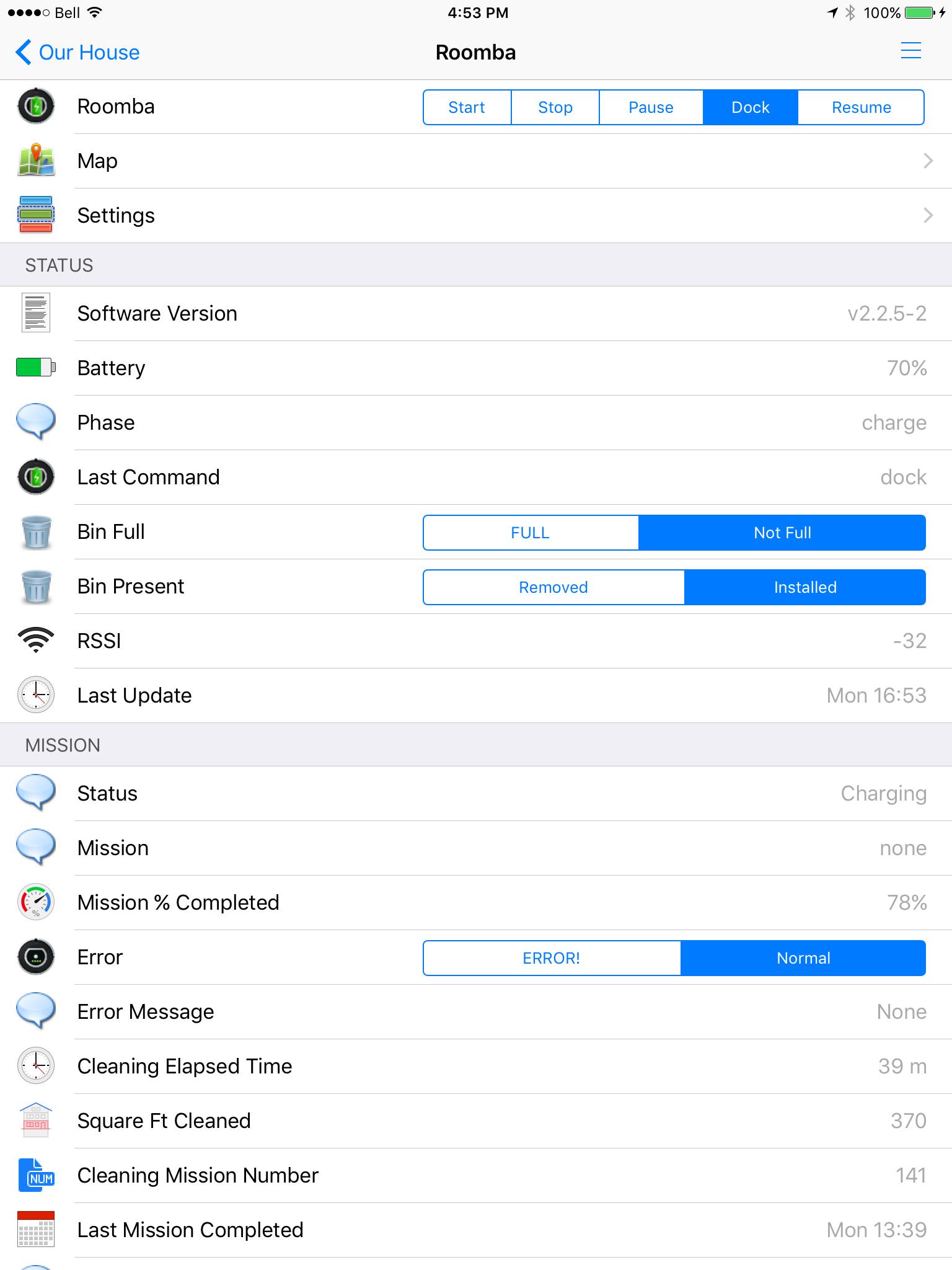

Here is an additional rule which monitors the roombaPhase and keeps other Roomba states correctly set. Without this, if the Roomba cleaning job was started manually (i.e. the clean button on the vacuum) then my active phone call rule would not trigger…
rule "Update various Roomba switches based on roombaPhase state"
Item roombaPhase received update
if (roombaPhase == 'run') {
roombaActive.postUpdate(ON)
roombaDock.postUpdate(OFF)
if (roombaPhase == 'charge') {
roombaDock.postUpdate(ON)
if (roombaPhase == 'none') {
roombaActive.postUpdate(OFF)
roombaPause.postUpdate(OFF)
Can anyone share some examples of how to set (i.e. POST) config options to the Roomba via an OpenHAB item? I would like to be able to control more low level settings like ‘cleaning passes’ and ‘edge clean’ via the OpenHAB UI…

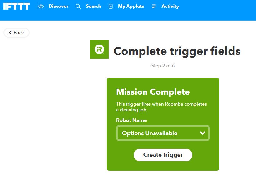

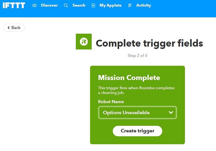

When you search at iRobot you find that there are a few mandatory steps needed and if I remember correctly, it also says you need to log in via your iRobot HOME app at least once into the cloud after the IFTTT feature has been activated. That was also a culprit on my end. I ended up deleting the irobot home app from my iphone and installed it again. I also reset my robot. Maybe there is a log-out feature somewhere but haven‘t found it yet.
But I think deleting the app from your iphone/ipad and then installing and log-in with your account should do the trick. Let me know if you succeed.
I don’t believe that you cannot set this up and would try to change the language on the IOS-device to EN as well as the robot language, do a reset and then install the app again. Don’t think that iRobot will sell different hardware all over the world except power supply.
And as last option you could potentially change your location in your iRobot profile if they put in a check there.
Good luck.
SJ
I guess the issue is the missing log in into the cloud via app. That was what solved my issue when I set it up. Maybe it is cashed somewhere. You could try a 2nd device and make a fresh install with the app and try then. Besides this, I am out of ideas.
I mean the log-in into their cloud. It only works if you log in at least once into their cloud. If you cannot log in via your smartphone-app then it does not work. How should their clould recognize your robot?
If you go to IFTTT and configure iRobot-connection it states that you need to log-in at least once.
That was what I experienced, then deleted the app as I could not find a log-in /log-out feature and reconfigured everything. Afterwards it worked. Maybe it is different on Android.
