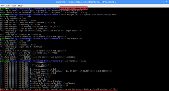

hi
i am blocked at “WARNING: PIL version is 4.0.0, this is not the latest! you can get bad memory leaks with old versions of PIL”
in spite of sudo pip install Pillow
Looking in indexes: Simple index, piwheels - Simple index
Requirement already satisfied: Pillow in /usr/lib/python2.7/dist-packages (4.0.0)
Someone ???
