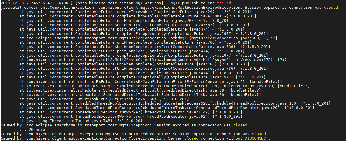

The way from my vacuum cleaner to OpenHAB works as expected. Data (JSON String) is delivered to item RoombaShadowJSON or RoombaWifistatJSON and processed in my “incoming” rules.
But when I set an item for outgoing commands like RoombaDock it is processed in my “outgoing” rule correctly but the command publishMQTT fails.
In the logs:
2019-12-05 13:51:38.563 [WARN] [nhab.binding.mqtt.action.MQTTActions] - MQTT publish to cmd failed!
Now I have no idea what’s the cause.

Is there a way to better debug this? I set log Level to [DEBUG] for mqtt. But there is no more info in openhab.log.
