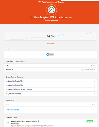

I have read the value of the Homematic thermostat in the following item:
Number:Dimensionless WT_Arbeitszimmer_Luftfeuchte "Luftfeuchtigkeit WT Arbeitszimmer [%d %%]" <humidity> (LuftfeuchteRelativMin,LuftfeuchteRelativMax,LuftfeuchteRelativ_Arbeitszimmer,WT_Arbeitszimmer) ["Point"] {channel="homematic:HmIPW-STH:ccu3:001D1A49905B3F:1#HUMIDITY", unit="%"}
If everything is correct the value is for example 64%.
After I run openhab for a while only some of my wall thermostat items show 0,64% instead of 64%.
This then crushes all my further calculations and so on.

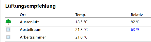

Here the wrong version before a restart.
In my widget the value is then empty:

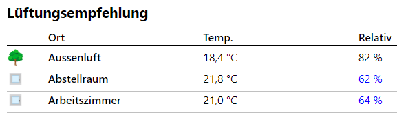

After a restart of openhab everything is fine again for a while:
