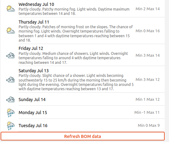

I use something similar in Australia.
Here is my rule that grabs the json data and I put that into a string item called BOMdata

I have a widget that displays the data:

This is what it looks like:
Maybe some of the code I have used you can modify to get what you want to work.
Good luck.

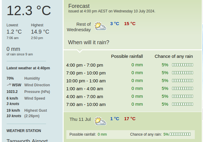

The data even gives you the chances of rain:
Which is in the json data. I don’t use that though but I could. I also have my own weather station so I know when it does rain here as well. The official BOM site is about 20km away from me.
