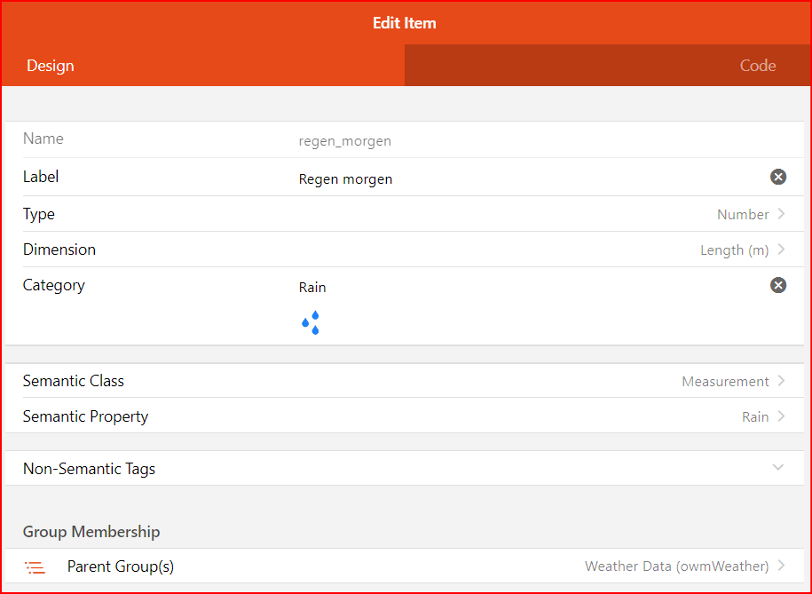

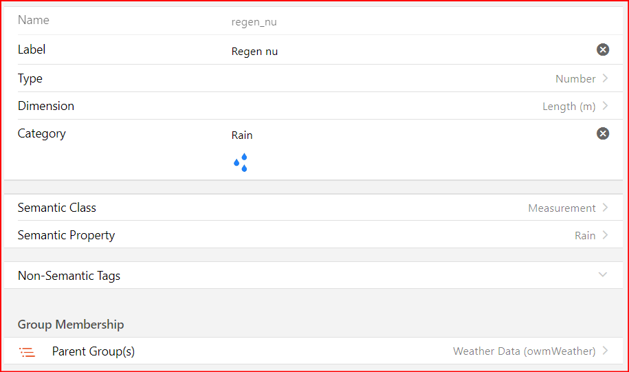

I assume this has something to do with the unit of measurement, with which I fiddled a bit to get it from m to mm…?
These are the two items:
regen_nu:
state description: %.3f mm
regen_morgen:

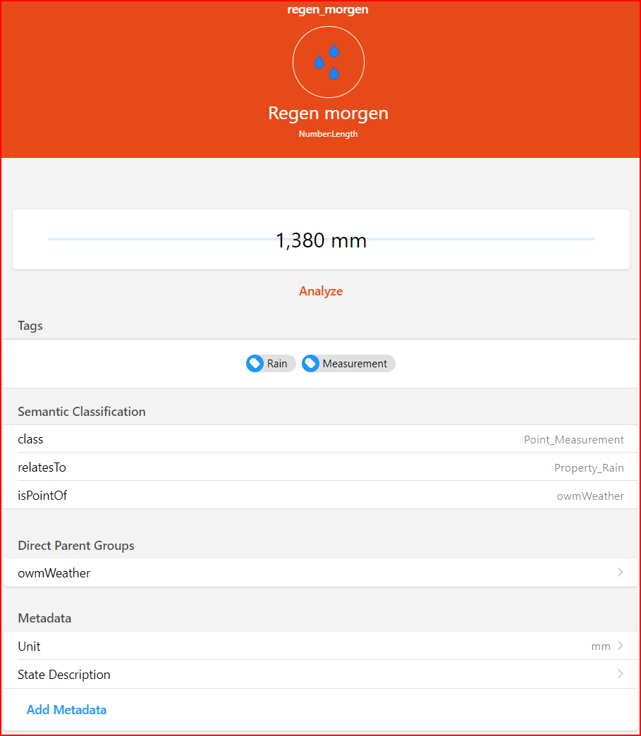

Anyone any idea why the “sum” isn’t in mm? And how can the product of 2 * 1.38 start with a 4?
(Also, it seems unlikely yesterday (I noticed this yesterday), today and tomorrow all experience exactly the same amout of rain (1.380 mm), but I assume that’s OWM ‘fault’?)

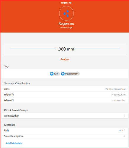

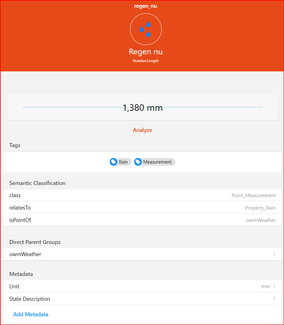

It also rained quite hard a few hours ago, but…:
This doesn’t aspire confidence in Openwearhermaps as source…
:man_shrugging:

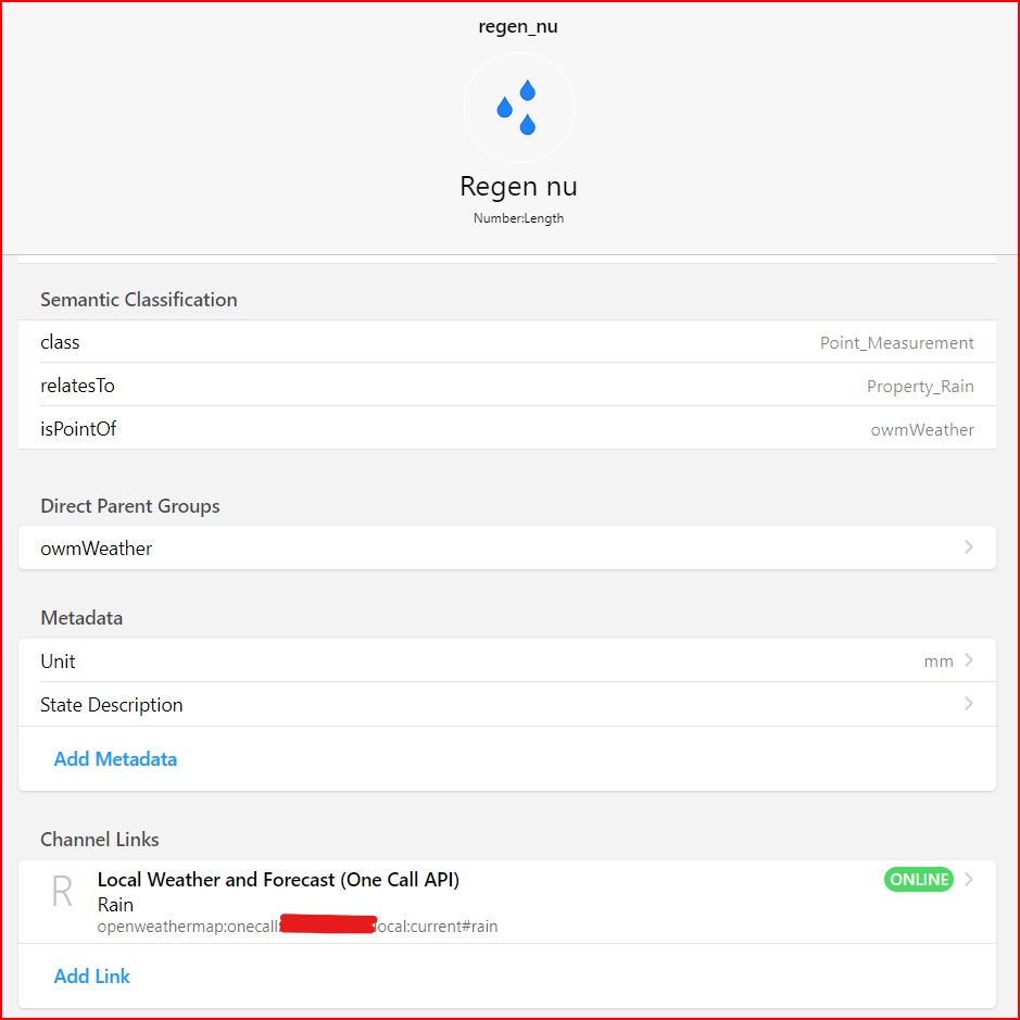

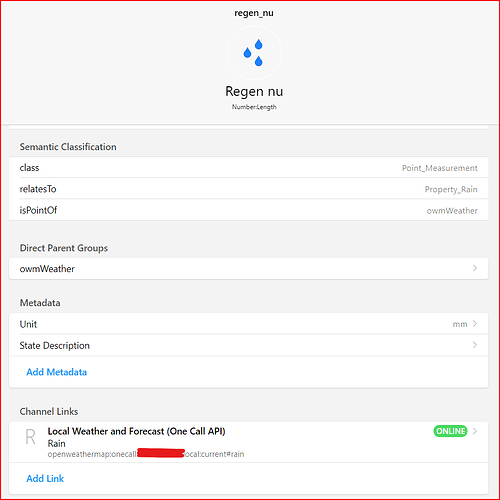

You don’t show what Channel that Item is linked to, how often OH polls OWM for new information, and lots of other factors that could impact this reading. For example, if it’s a forecast Channel, it’s not going to reflect the actual amount of rain that fell. If rain fell unexpectedly the forecast Item would remain 0.
Depending on where you live, no forecast or even now cast is going to be that good. Where I live temperature can vary by 5-10 °F in as little as half a mile and it could be raining heavily across the street while my yard remains dry. No weather service can handle that well. If you want accurate weather info about your location, you need your own weather station.
However, if that Item is linked to the Rain Chanel under Current Weather and the rain started more than the OWM polling period ago (I think 10 minutes is the default) I would expect that Item to show some values other than 0. Note that the Channel represents the amount of rain that has fallen in the last hour so it’s not going to be useable for much else (e.g. total rainfall over the past day).
Apologies, you’re right.

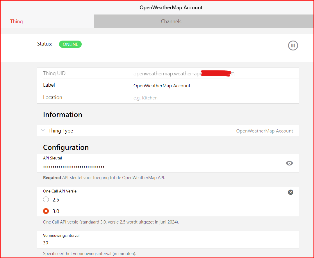

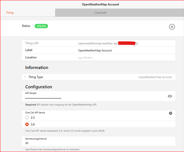

OK, so that Channel does reflect the actual measured amount of rain that has fallen,. However, it only updated every 30 minutes. So if it started top rain 29 minutes ago, it will take another 30 minutes before any rain reading is reported. If it started raining 31 minutes ago, it will take 30 minutes before any meaningful amount of rain will be reported.
And any value reported to this Item is only going to cover the past hour. When it stops raining the Item will return to 0 60 minutes later.
Note: the random string in the Thing UID that you’ve redacted has no meaning. It’s randomly generated by OH to ensure each Thing has a unique ID and is not related to your API key, OWM account or anything else. You don’t need to redact it..
Also, it is pretty much always better to click on the code tab and paste in the YAML you find there than it is to post screen shots. Screen shots cannot be searched, copied and edited, and usually leave out a whole lot of useful information. Though do be careful to redact API keys and passwords and such from the YAML before posting.
Okay, but then the “analysis” of the past day (as I posted above) should not be “0”, right?
