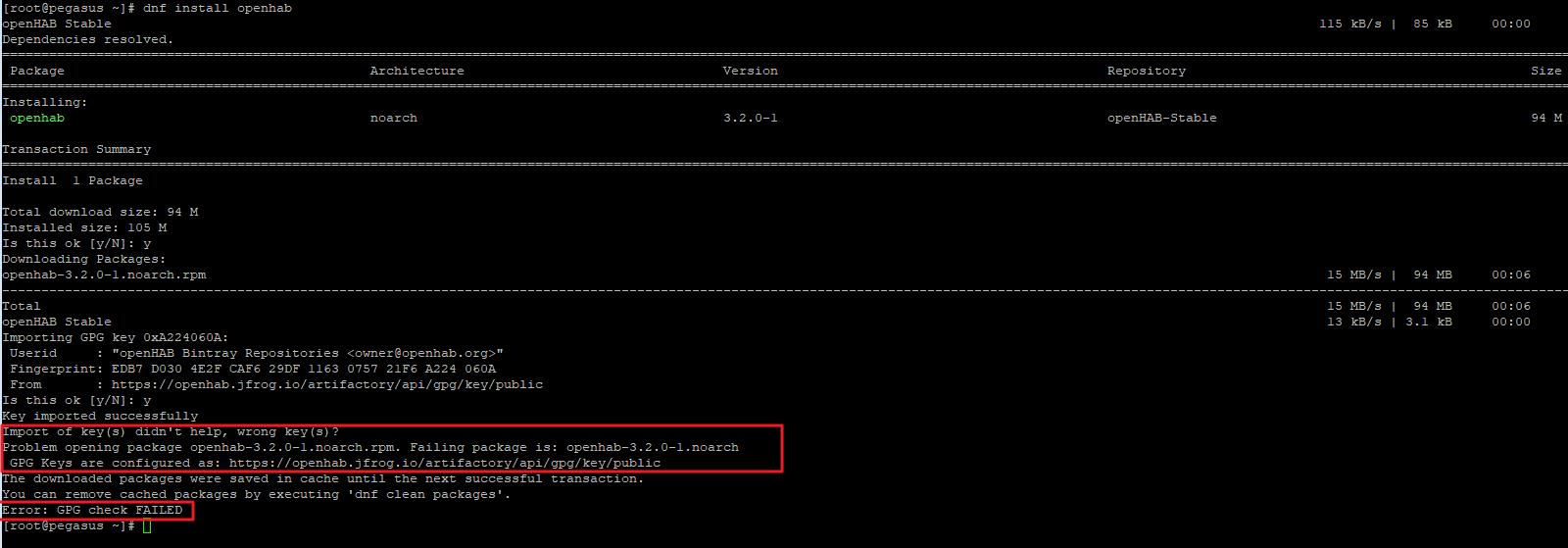

I’m looking to understand if OpenHAB 3 is supported on CentOS 9 Streams.
The documentation seems to suggest it is, however when attempting to install OpenHAB 3 using the jfrog repository (JFrog) I’m getting an error.
The following is the output following the installation of the GPG key which is done by dnf.
Key imported successfully
Import of key(s) didn’t help, wrong key(s)?
Problem opening package openhab-3.2.0-1.noarch.rpm. Failing package is: openhab-3.2.0-1.noarch
GPG Keys are configured as: https://openhab.jfrog.io/artifactory/api/gpg/key/public
The downloaded packages were saved in cache until the next successful transaction.
You can remove cached packages by executing ‘dnf clean packages’.
Error: GPG check FAILED
I have also attempted to attach a screenshot of the full command and output. The key seems to have been imported successfully. While I’m not familiar with this error it seems there could be a problem with the key.
Any help or guidance is greatly appreciated.

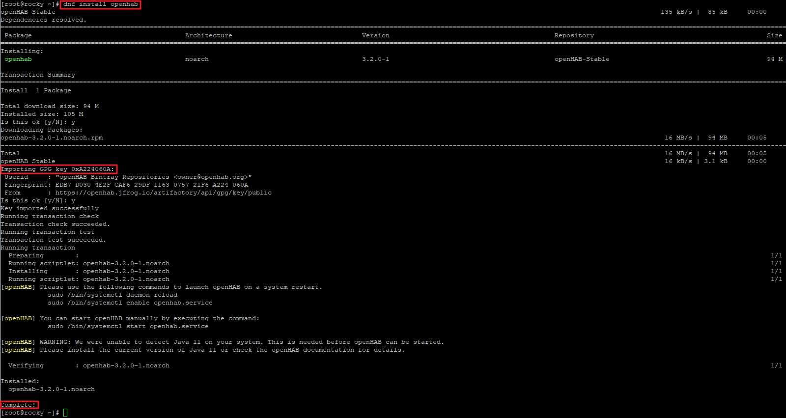

I went back and tried the installation on a different distro (something other than CentOS Streams) and this issue did not occur. It seems this may be something specific to CentOS Streams.
I was able to successfully install OpenHAB 3 on both Rocky and ALMA without issue.
My guess is there is something up with CentOS Streams.
I attached a screenshot of the successful outcome.
I’m going to take the advice of those who suggest looking at Docker and give that a try.
