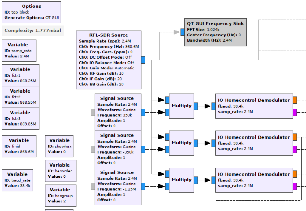

  • Sample rate is 2.4 MHz
  • Center Frequency was set to 868.6MHz, so that I can sample the three channels mentioned in the ADF7022 Datasheet (2-page version) at once.

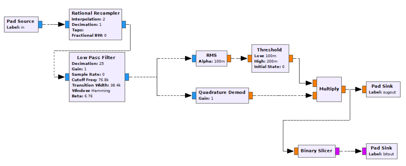

  • To demodulate, I first mix each channel down to the base band (the multipliers in the above graph) and then demodulate them using the following graph
  • First step: Interpolate to twice the sample rate (2.4 → 4.8 MHz)
  • Low pass filter with twice the baud rate and decimate down by 25.
  • This results in a sample rate of 192 kHz
  • Why? this is exactly 5x the symbol rate of 38.4kbaud
  • The signal is split in two paths
    The amplitude to actually recognize packets and blank the noise floor by a threshold.
    A quadrature demodulated signal.
  • Both signals are recombined by multiplication.
  • One output carries the “analog” signal, the other one the bit sliced version (only 0 or 1)

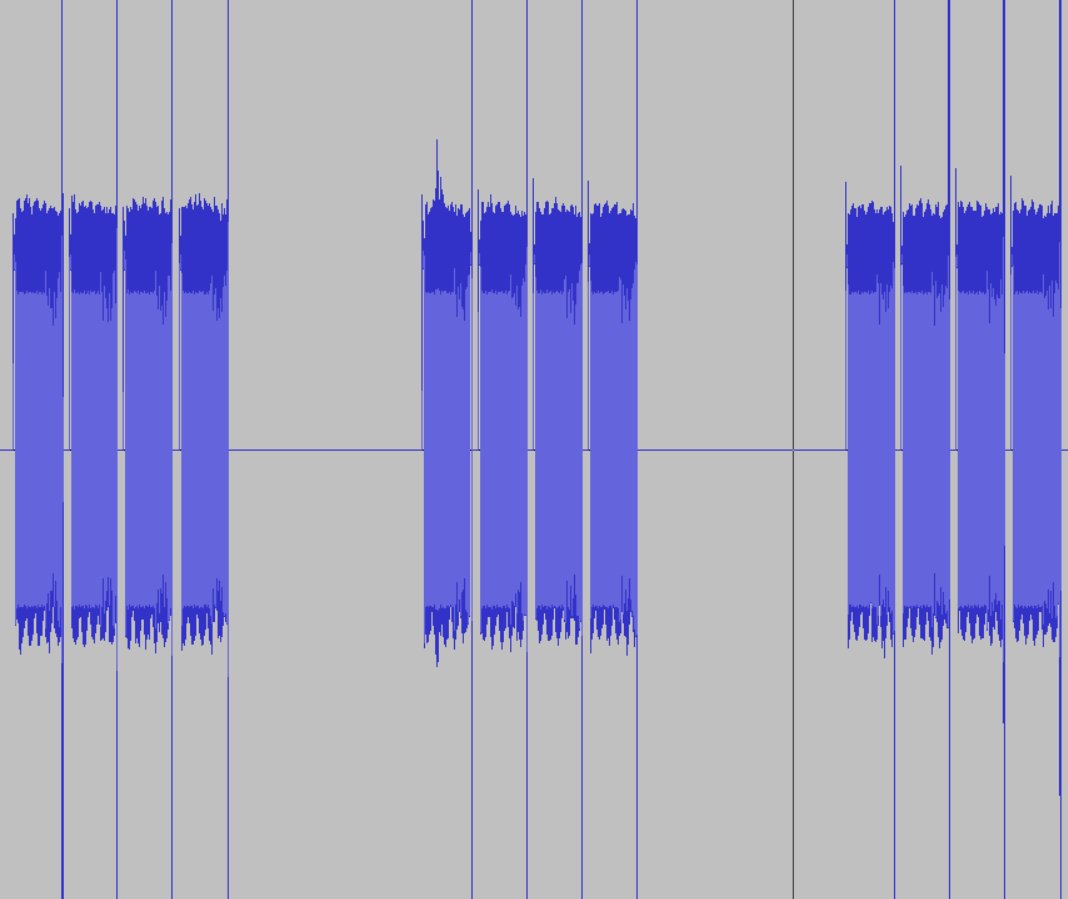

The resulting “analog” signal can be stored in a wav file which, cropped to one transmission, looks like this:
  • There are three groups of four packets each
  • The four packets in each of the groups are bitwise identical.
