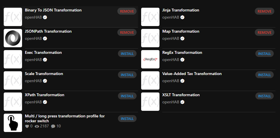

And I ran into another issue:
[WARN ] [t.generic.ChannelStateTransformation] - Transformation service JS for pattern NousOut.js not found!
And it’s correct, there is no such transformation installed - but also not available.
I’ll try your attempt now…uff.
That’s correct, as there is no script transformation service at all.
The thing is, you can now use any script engine which is installed to do a script transformation.
In older openHAB versions you had to install JS Transformation Service and you were bound to JavaScript Scripting for Transformations.
The Log message is a bit vague here but you’ll simply have to install the JavaScript Scripting engine.

Okay, got it. In order for JS to be functional I had to install the script engine. How ever, I now got it working using your transformation patterns. I only had to change
