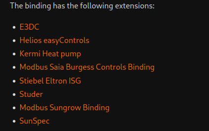

This is exactly what the modbus extensions are for. At this moment, those bundles need to be coded in java - there is no general purpose config format to define equipment if that is what you are asking.
In a way, they are built “on top of” the generic modbus functionality, and allowing the extension developer to focus on parsing and processing the binary data from modbus data to openHAB channels that represent the physical device.
‘extentions’. Ive been using the wrong word ‘bundle’. This is exactly what I’m talking about.
I’d be happy to do the boring data entry if someone else will guide me and stick it all together
How about a tool that creates an extension? That way, the existing binding need not change at all?

I agree that the modbus extensions are probably the best approach, a similar approach is also used with the mqtt binding. However while in general I would be willing to contribute such an extension it would be a lot more work than simply creating things (especially since mine are already there :smiling_face:). Therefore I would only contribute this if I knew that I can help somebody in the community. Maybe a poll for interested users would be good to see which devices are used by the community members?! I have an Alpha ESS inverter btw if someone would be interested :wink:
