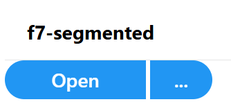

You could create it with an f7-segmented control.
If it were a custom widget in MainUI, I rebuilt it like that (just to show the concept):
    - component: f7-segmented
        round: true
        bgColor: blue
        color: white
        style:
          width: 150px
        default:
          - component: oh-button
              text: Open
              style:
                width: 70%
                border-right: 3px solid white
              text: ...
              style:
                width: 30%

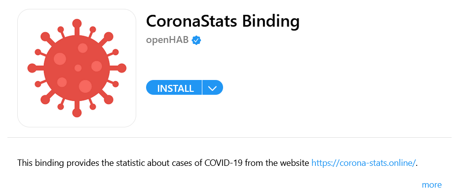

The button itself is working fine, but I have a problem with the associated popover (when using the “right part” of the button).
I understand that I’m doing something wrong, I just can’t figure out what: I define the <f7-popover> element in a template, so that it ends up somewhere down in the hierarchy in the DOM, with display: none. But, when it’s opened, a new element is inserted under the framework7-root DIV, which is displayed. However, when this is closed, the created element isn’t removed, it’s opacity is merely set to 0. That means that it’s still there, and blocks clicks to the elements which it covered while it was “open”.
Even worse, a new such element is created each time the popover is opened. I realize that there must be something wrong with the way I close the popover, I just can’t figure out how to do it properly. I have made the popover close when an option is selected, and it’s this “closing” that doesn’t clean up properly. If I click the “backdrop” instead, the element is removed and everything is fine.

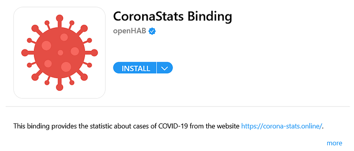

There are two vue templates involved in this. Please not that this is a work in progress, so don’t look at the stuff that’s not related to opening/closing, as some things are just there because of testing and some things aren’t made yet.
<template>
  <div class="addon-install-button">
    <f7-segmented v-if="versioned" class="split-button" round :bgColor="buttonColor">
      <f7-button class="install-button" :text="buttonText" small @click="clicked()" />
      <f7-button class="install-menu-button" popover-open=".addon-version-select" icon-f7="chevron_down" small />
    </f7-segmented>
    <f7-button v-else class="install-button" :text="buttonText" :color="buttonColor" round small fill @click="clicked()" />
    <addon-version-select @version-selected="(v) => versionSelected(v)" :addon="addon" />
  </div>
</template>

I think I know what happens now. When a selection is made in the popup, version-selected is emitted to the parent which makes the parent reload its content. In the meanwhile, the popover is doing its “closing animation” - so that when it’s finally done with the animation, the contents of the DOM has changed and it fails to complete the “hiding” of the correct element. In the meanwhile, a new identical element has appeared, and whatever action is to be taken when the animation finished is applied to that instead. Thus, the “old one” remains as an “orphaned element”.
I’m not sure how to solve it though, I probably need to wait for the animation to finish before emitting - but I’m not sure how. I guess I must use some event somehow.
It seems like I got it working now (by waiting for the animation to finish) with this commit:
https://github.com/Nadahar/openhab-webui/commit/50e76c7d5266f462d2558608b512ac5e85e996c6
I had to suppress an eslint because I set a variable in a “computed” method, so it’s probably considered a bit hacky - but seems to work.
I need to keep track of what the initial selection is, to avoid emitting (and thus reloading) if the same version that is selected is “selected again”, and since I figure this out in a “computed”, that’s bad behavior. So, the solution would probably have to be to not do this is “computed”, but it’s unclear to me exactly where it should be done. “Computed” fits nice in that it is only done once unless “this.addon” is changed (as far as I understand), which avoids doing unneccesary calculations. I guess that “this.addon” never actually changes (I don’t have the full overview of how Vue/F7 works, so it’s somewhat of an enigma to me exactly in what order things run), so that it could be calculated in some “load” method instead. But, I don’t know how to trigger a “load” method since this is a component, not a page (for which I have found examples of a “load” method) - and as I don’t have the full overview of what is invoked when, it’s not tempting to try to do just to get rid of the warning.
The reason for the warning is that “it’s confusing” when “computed has side effects”. To me, that’s not even remotely the most confusing about all this :wink:
