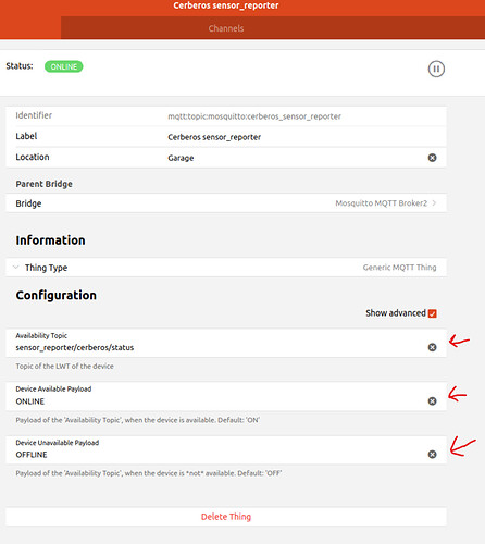

On every Generic MQTT Thing you can set a LWT topic and an online and offline message in it’s configuration. When the LWT has the offline message posted the Generic Thing will be marked as OFFLINE and all the Items linked to the Channels will be set to UNDEF.
Note that for this to work the device needs to publish both an ONLINE and OFFLINE message to the LWT topic and the messages must be published as retained.
UID: mqtt:topic:mosquitto:cerberos_sensor_reporter
label: Cerberos sensor_reporter
thingTypeUID: mqtt:topic
configuration:
  payloadNotAvailable: OFFLINE
  availabilityTopic: sensor_reporter/cerberos/status
  payloadAvailable: ONLINE
bridgeUID: mqtt:broker:broker
location: Garage
channels:
  - id: garagedoor1
    channelTypeUID: mqtt:contact
    label: Large garage door
    description: Large garage door open status
    configuration:
      stateTopic: sensor_reporter/cerberos/garagedoor1/state
      off: CLOSED
      on: OPEN
  - id: garagedoor2
    label: Small garage door
    description: Small garage door open status
    configuration:
      stateTopic: sensor_reporter/cerberos/garagedoor2/state
      off: CLOSED
      on: OPEN
  - id: garagedoor1_opener
    channelTypeUID: mqtt:switch
    label: Large garage door opener
    description: ""
    configuration:
      commandTopic: sensor_reporter/cerberos/garagedoor1/cmd
      off: OFF
      on: ON
  - id: garagedoor2_opener
    label: Small garage door opener
    description: Small garage door opener controller
    configuration:
      commandTopic: sensor_reporter/cerberos/garagedoor2/cmd
      off: OFF
      on: ON
  - id: online
    label: Online status
    description: Indicates online status of this sensor_reporter
    configuration:
      stateTopic: sensor_reporter/cerberos/status
      off: OFFLINE
      on: ONLINE

I missed that. If that’s the case @aturlov, the answer is no, you can’t. The 2.4 version binding doesn’t have these options to set the LWT on the Generic MQTT Thing and there is no way to set the status of a Thing from a Rule.

The feature was introduced sometime after OH 2.5.3 I think. If you upgrade to 2.5.11 you should get it with minimal work and you can save the upgrade to OH 3 to do at your leisure.
Just upgraded to 2.5.11 and now see the option to configure the Availability Topic on Generic MQTT things. Thanks for your help.
